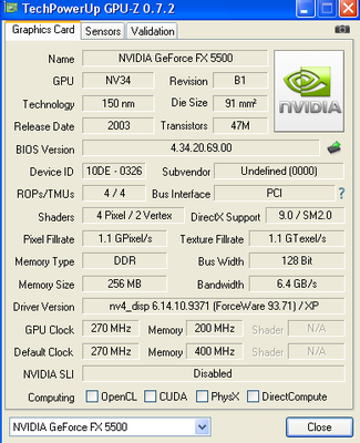

Reply 5 of 7, by t9999clint
I think I'm gonna stick with plain old PCI.
You think something like this will work well with W98 with nGlide?
nVIDIA GeForce FX 5500 256MB PCI

Reply 6 of 7, by cyclone3d
It should work.. but my guess is that really has an FX 5200 GPU under that heatsink that they just overclocked and changed the BIOS string on.

Reply 7 of 7, by agent_x007
Well FX 5500 is a overclocked FX 5200 w/128-bit bus.
I own similar card : LINK
Here's GPU-z screen :
