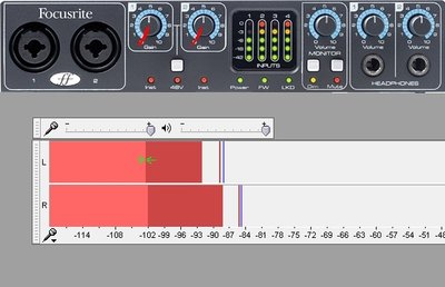

BTW, What is the noise floor in RMS (noise is measured only in RMS) of your line-in with the levels at max?
On my Focusrite audio interface with the preamp gains at zero (max voltage input) and line-in levels at 100, I get -102db (marked in green).
62.2 KiB
2033 views

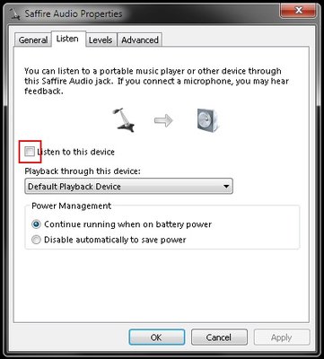

No, it's a standard procedure to measure Frequency Response, Latency, Distortion and other parameters of a sound cards or audio interfaces.
You have to make sure that the "Listen" option is UN-ticked (default) or else you will get endless feedback, if it is ticked you will hear the signal, so you can play with your CM-64 and DOSBox for example.
Besides, the Line-Out should be much less-Hot than the MT-32, moreover, the Line-In has protection diodes on the input so it's not actually clipping at the op-amp rails.
Worry not.
48.85 KiB
2044 views

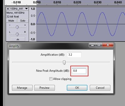

You can import (simply drag into audacity) the 100Hz test tone into Audacity and Normalize it (Effect-Amplify), and play from there.
53.65 KiB
