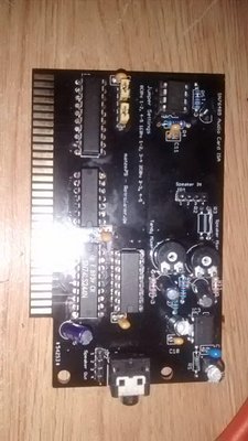

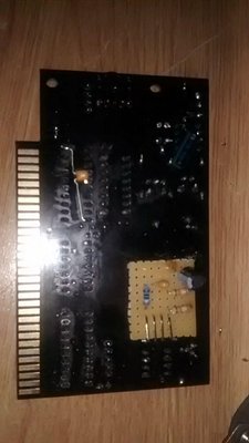

Reply 120 of 456, by matze79
112 KiB
2484 views
78.83 KiB
2484 views
All PC-Speaker issues are fixed now and now its also short circuit safe.

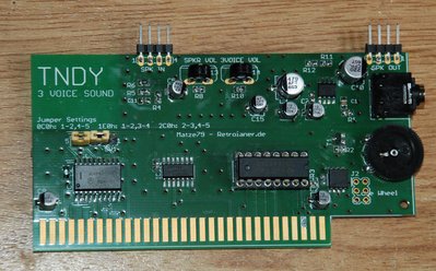

Reply 130 of 456, by matze79
still some small adjustments needed, current progress :

Reply 136 of 456, by matze79
looks lovley but has EMV problems.. so needs redesign i cut few things on the pcb and wired the gnd and vcc directly to power supply and so on..
still noise inside the signal.
my two testing boards on perfboard did work fine.. so it must have todo with the pcb design..
Reply 137 of 456, by root42
That is something that eludes me completely. How does one go about reducing noise on the PCB level? I remember one video by Dave from EEVblog where he simply added two layers to an already two layer board, simply by adding one pure GND and VCC plane, iirc. That supposedly reduced emissions as well. Not sure about the physics behind that.
YouTube and Bonus
Reply 138 of 456, by matze79
this way parasitic capacitance is eliminated i think.
Reply 139 of 456, by Tiido
Planes increase parasitic capacitance, which (un)intentionally helps to round off the signal edges slightly which will reduce emissions. Their main positive effect comes from reduction of loop area on return currents etc., the noise can couple straight into the plane rather than through other stuff elsewhere, so less has to radiate outwards or into other stuff.
