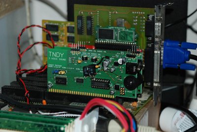

Reply 142 of 456, by matze79
Next PCB is on Order..
i figured out the SN76489 is sounds quite different to IBM PS/1 3 Voice Sound.
Also got my hands on tandy 1000, sounds slightly different but only minimal.

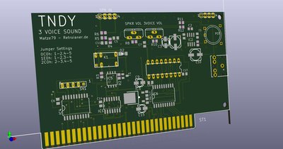

i trying to convert everything to kicad now.
As i have not enough space to fit everything on free eagle version.
Especial if i want to add the bracklet to the design.
unlikly everthing is different in kicad so i need to figure out howto i get my ground planes working..
EDIT: Fill all Zones -> Found it.

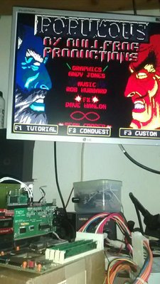

Reply 152 of 456, by Tiido
All the TI PSG chips have the "Audio In" pin, including the early ones where the datasheet doesn't tell it is one. The pin connects to the negative input of the internal amplifier and cannot be tied to GND or other stuff that forces a DC offset or the internal reference gets messed up and you get garbled or no sound. Connecting a 68pF capacitor from output to that pin will stabilize that amplifier and oscillations seen in the output will stop, increasing sound quality, this works on all the TI PSG flavors.
Reply 153 of 456, by matze79
oh i will try that, maybe it will stop sound problems.
Reply 154 of 456, by matze79
Thanks this does the Trick, the oscilations magically disappered.
i used a Busdriver, a 7805 and decent filtering before to archive nearly same result..
i played populus a bit, and it sounds much better!
131.22 KiB
2478 views
i cancelled the pcb order and will adjust the smaller one now 😀

Indeed! also works perfect on dreamblaster TNDLPT Plug 😀
Reply 157 of 456, by matze79
121.99 KiB
2435 views
Stereo ? 😀
it finally works the way i wanted.
Now PC-Speaker Output remains working when sn76489 is cut from amplifier.
The 1N4001 will be omitted, its only because i only had 3V OMRONs.
i now want to test activating the audio signal from SN76489 by pulsing OE with multiple writes to 0c0/2c0/1e0 in a certain pattern.
