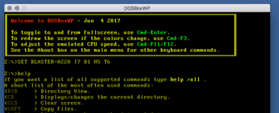

]Here is a mystery I hope someone can help me solve. I've been building DOSBox for years under both OSX/macOS and Windows (using both Visual Studio and MinGW), using a modified version of the source that owes a lot to helpful people on this forum. Recently I've tried using the same source code for both my OS X builds and Windows builds, and I came across this problem.
When I build under Windows, the startup screen shows the correct ANSI.SYS colors. When I built under OS X in the past (using older versions of my code), I also got the correct ANSI.SYS colors. But when I try to build my current code under OS X (macOS Sierra, actually), I get the wrong colors shown in the attached screen shot.
I can't see anything wrong with the code in shell.cpp, so it seems that something is going wrong somewhere else, perhaps in configure.ac, though I can't imagine what it might be. Here's the relevant shell.cpp code:

Can anyone guess what's going wrong here? I'll be very grateful for any help.
PS I use a version of my OneStopDOSBoxOSX script (all ideas by Dominus, not me) to build my code:
https://github.com/emendelson/OneStopDOSBoxOS … topDOSBoxOSX.sh
[attachment=0]Screen Shot 2017-06-04 at 5.07.41 PM.png[/attachment

Reply 1 of 13, by ripsaw8080
Rank DOSBox Author
DOSBox Author
It certainly resembles the issue seen before with hi-color modes on Macs: NBA Live 97 on Mac
Your situation seems worse, however, with text modes affected (I doubt it's specific to ANSI colors). In any case, it's presumed to be an endianness issue. As I mentioned in the linked thread, a reversal of ARGB could account for the scrambled colors, so perhaps you can investigate the cause based on that.

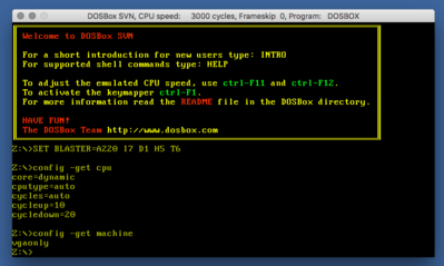

Reply 8 of 13, by emendelson
ripsaw8080 wrote:
The machine=vgaonly setting uses 16-bpp drawing to support line-wise palette changes, so it would seem to be susceptible to the issue. Can you confirm that with a vanilla SVN build on your Mac system?
Yes, as you thought, the issue occurs with pure SVN. The screen shot has the details:
44.83 KiB
2231 views
I'm not sure this is relevant, but the issue seems to occur only if machine=vgaonly is set in the .conf file. If it is set in the .conf file, then a change in the setting from the command line has no effect; if it is NOT set in the .conf file, then a change to machine=vgaonly does not cause the issue to occur.
PPS: As you see from the screen shot, I use config -get cpu in my tests. This is to make sure that I don't have the problem where dynamic crashes in an OS X build.

Reply 9 of 13, by ripsaw8080
Rank DOSBox Author
DOSBox Author
Thanks for checking. It makes sense that vgaonly is affected, but I don't recall that being noted about the issue before.
When changing the machine= setting at the prompt, it won't go into effect until DOSBox is restarted. In SVN you can write the changed setting and restart from the prompt with: config -writeconf -r
