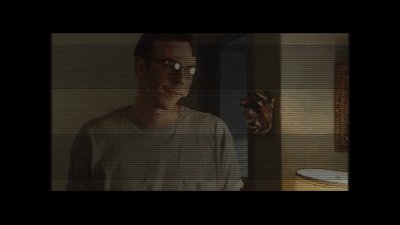

By the way, OpenGL doesn't work well with DosBox. Most games will crash if you set them to OpenGL. The only game I know that didn't crash and had it's graphics greatly improved with OpenGL was Darklight Conflict.
Personally I prefer using either Ddraw or Overlay. I use Overlay with games that have FMV, like Phantasmagoria 2, because with Ddraw the video will look like this!
216.41 KiB
3350 views
As for scaler I suggest either normal2x, or hq3x and supereagle. Normal if you want the original experience and hq3x - supereagle if you don't like it pixelized.
