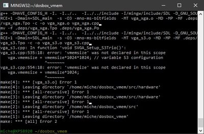

I'm currently trying to get the video memory configurable via the conf file, but lacking C++ skills, this is all I could come up with until now:

Of course, this doesn't compile. Can anyone help me out here? How can I "connect" the value in the cpp files to the variable used in the conf file of the compiled binary?

Reply 9 of 15, by Yesterplay80
Thanks, it compiles now, but no matter what I set for vmemsize in the conf file, VBETEST always reports back only 512kbyte of video memory, which seems to be a fallback minimum defined in vga_s3.cpp:

Reply 10 of 15, by spiroyster
Actually scratch that change to get it to compile. The line doesn't make sense.. since the previous condition checks if vga.vmemsize is 0, the expression is always going to evaluate to 0.
Need to see the rest of the source to see where the vmemsize (not vga.vmemsize) value is defined. Is that code you posted just the diff from sourceforge?
[EDIT:] I don't think having a variable vmemsize for S3 hardware is going to work. Like ripsaw said, you need to set the registry value that corresponds to the size of the buffer, unless you know that you will be out of luck.
