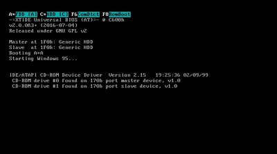

Reply 125 of 142, by superfury
Yay! Good news: floppy disk booting is working now on the Compaq Deskpro 386! 😁 Finally can boot the Windows 95 floppy disks with required stuff for Windows 95 setup:D (Instead of plain MS-DOS already installed on the hard disk)!

First-time Windows 95a boot disk booting on Compaq Deskpro 386!

Reply 126 of 142, by vladstamate
Congrats dude!
