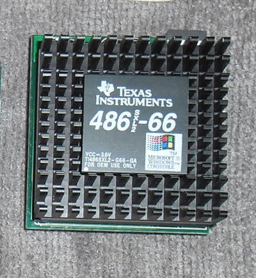

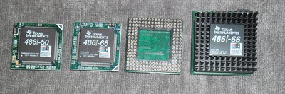

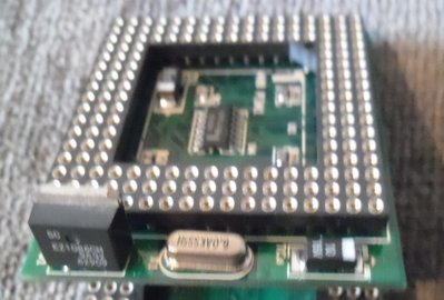

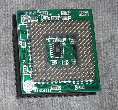

A CPU collector sent me some photos of another SXL2-66 upgrade, this time PGA-168 with VRM. This is what we're trying to replicate, minus the unnecessary extra circuitry. This adapter uses an EZ1086CM as the VRM. I have never seen one of these adapters in person or in photograph until now, so I suspect it is exceedingly rare.

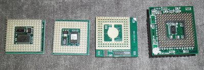

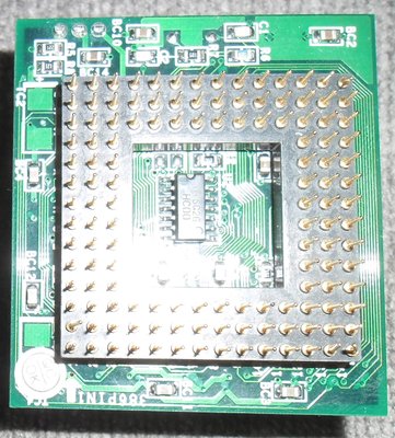

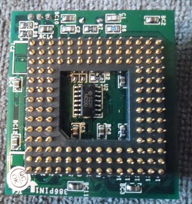

Here are some side-by-side shots of the three known SXL2-66 adapters. Interesting how one manufacture chose to centre the PGA, while another offset it to the corner. The offset one does not come with a VRM.
