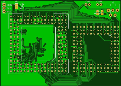

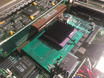

Before I start, let's get a few things out of the way:
-This is my second PCB ever; I am confident that to a professional it looks like a toddlers doodle
-I selfishly made this to fit my computer (IBM P70 luggable), it may not fit yours - this is not an universal interposer
-I'm running with a 20MHz clock, doubled to 40MHz. The trace length is such, that for 40/80MHz it should still fall in the 2.5% skew allowed by JEDEC. So, it could work at those frequencies, but I have no way to test this
-I'm still having issues getting the cache working. The board doesn't have any coherency circuits, something I regret now.
Design and build
In this thread, the envisioned end product would be a pcb roughly the size of the processor, with pins at the bottom and a socket at the top. This would require a smd 168 sockets, and a smd 132pin array. Despite extensive searching, I did not find these components. I did however have a though-hole 168pin socket (for 486s) lying around. I reckoned the only way to have two though hole arrays would be to put them side by side.
This is of course not ideal - wire lenght increases - but it was the only way I saw this becoming a practical reality. I updated the circuit of CB88 (who left a few pins unconnected) and added in the MIC29152 regulator discussed in this thread. The real work was laying out the tracks. What you see here is my third attempt; earlier versions always drowned half-way because of too large traces or orientating the sockets in the wrong way. The traces are now the thinnest allowed by JLCPCB, and even then it barely fits here and there.
265.07 KiB
1114 views
The PCB does not have many options. The power regulator puts out 3.5V. This is fixed, but can be altered by changing out R1. There is a header for a 5v fan and a connection to the MEMW pin. Also, there is a solderjumper that allows to set pin J1 to 5V or vcc (3.5V). Only make this 5V for the SXL-G40 and SXL2-G50, all other SXL processors need vcc (3.5V).
The 132 pin side is just holes. I bought 0.5mm 24AWG wire. I used a space 132 pin socket placed at the right distance to accept the wire, solder it, cut it off. Repeat, 131x. The result is a pin array that is surprisingly rigid, not much worse than an actual processor.

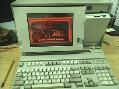

My system (IBM PS/2 P70) started normally with the interposer. I used the cyrix.exe utility to double the clock (-cd), which took it to 40MHz in Norton sysinfo. I did add a little heatsink, as the processor got quite toasty (not burning my fingers though).
96.51 KiB
1114 views
70.62 KiB
1114 views

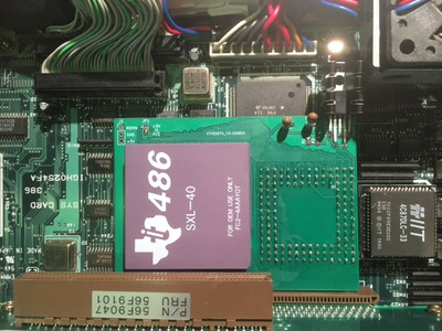

I've been less lucky with the cache though. Getting the cache working on the 486DLC that was in there originally was already a headache - I got it kinda working with flush and defining an exepted space. But for the 486SXL-40 none of this works. Flush (-f) or Barb (-b) don't do anything, doom isn't faster and the cache doesn't end up in cachecheck. As soon as I exept a portion of the memory the system becomes unstable. I don't think this is a fault of the interposer, more of compatibility issues between my (1989-) computer and the processor.
In any case- suggestions for how to get that working? I have seen mentions of some simple circuit that is needed to get cache coherency with Flush, but couldn't find anything on it. Can anyone point me to where I can find something on that?

Nice work. To make the sockets on top of each other, I'm fairly confident you'd need 4 or 6 layers. From what I can tell, your design is 2-layer?
You can still find PGA-132 and PGA-168 sockets NOS, usually on eBay or via some electronic warehouses throughout the US or China. I know I have a bin with some. But you can also use single row machine pins to form up the sockets, like I did with my first wire board prototype.
Any reason you decided not to include the through holes for the trimmer to make this unit adjustable?
As for why you are having issues with cache coherency, I don't know. The MEMW circuit can be found in the TI486SXL databook, which unfortunately, is too large for me to attach here. I was pretty sure there was a link to it in this thread though, is there not? If nothing turns up, I can PDF the few pages of interest in the next few days. I'm trying to get my home's foundation put back together before the rain comes, so no time at the moment. I'm replacing the perimeter drains and sewer pipes by hand with paver surrounding the home. It is considerably exhausting.
If you have a spare board, populated, or unpopulated, that you'd like to mail, I can test it out further.

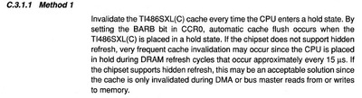

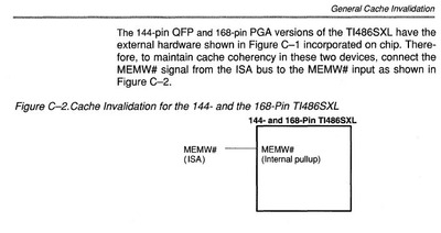

I have a copy of the databook, and for the 168 pin version the MEMW circuit is built into the chip. Only thing to do is connect the MEMW pin to the ISA MEMW. Only thing is; I have a MCA system which doesnt have a MEMW pin. Maybe I should ask TexElec or something...
41.88 KiB
1076 views
Alternatively I could BARB, but unless my board supports 'hidden refresh' (I'm guessing not) the cache would be invalidated so often as not to be useful.

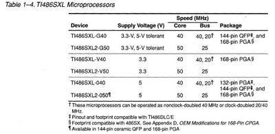

Man, you guys gave me a lot to figure out. First thing; what VCC needs my processor? The ebay listing I got it from says its 3.45V, but that is no authority. I checked the TI manual and this comes up:
51.64 KiB
1014 views
What I have can be either a -G40, -V40 or -040, with only the -V40 needing 3.3V, the other two can run on 5V.
My chip says 486SXL-40, but it's too easy to just conclude its the -040. If you google a picture of the G50 for example, the big print on the package is -50, G50 only is printed in the small code at the bottom. I could unfortunately not find any pictures of the -V50 or -V40, nor does any online collection list have them, which suggest they are very rare - or....they just look the same and nobody figured out what they have. So jeez, how can I be sure?
