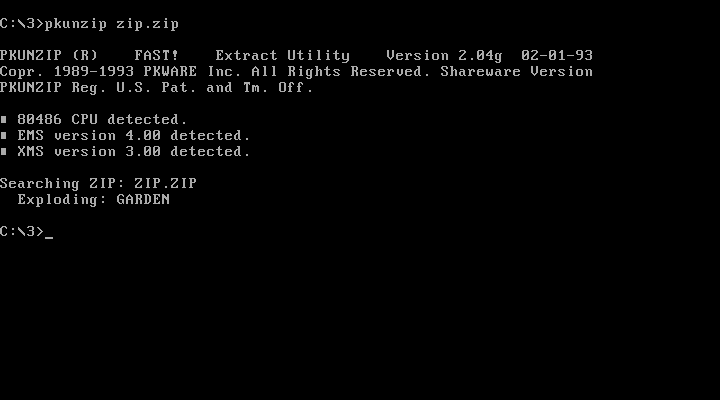

Sorry, I meant EMS. Pkunzip does support different porcessors, though. As for SimCity, I think it did help quite a bit.
The whole simulation was very number-heavy, afterall. Another game supporting FPUs might be SimEarth, but I'm not sure.
3.82 KiB
2088 views
