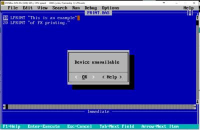

I am working on an art installation part of my MFA at UCLA. I am re-creating an office from the 1980s, using vintage office equipment. All of the computers, equipment, keyboards are alive and working with people (keyboards printing themselves, computers running terminal commands, etc)
I have an Epson FX-85 I am attemping to print using a super simple QBASIC / BASIC program.
The printer prints perfectly using the DOSBOX-SVN-LFN build using simple dos commands (EX. DOS > LPT1 )
However, when I attempt to print using QBASIC, I am told that it cannot find the printer:

Does anyone have any suggestions or thoughts? If not, can you please direct me where I mijght be able to find answers?

DOSBox does not have printer support. You will need to use an experimental build of DOSBox, or better yet try vDos. https://sourceforge.net/projects/vdos/

As mentioned in my post above, I am using a build of dosbox which allows printing.
I can print out a directory using the command DIR > LPT1, but the LPRINT command does not work in qbasic.

If you have special functionality you have questions about, please contact the maintainer of that version of DOSBox or the author of the printing patch, whichever is easier. Alternately, have a look at VDOS as recommended by collector. It's built to run vintage office software.

QBASIC will *not* function properly in vDos because vDos lacks keyboard INT9/IRQ1 support. You are recommended to try vDosPlus (vDosPlus.org) instead. vDosPlus has *all* features of vDos plus many many more.
P.S. I am the maintainer of both DOSBox SVN-lfn and vDosPlus. The printing support in DOSBox SVN-lfn is relatively basic; for advanced printing support you are strongly recommended to use vDosPlus instead of DOSBox SVN-lfn in this case, and in recent days I am more focused on vDosPlus developments. Hope this helps.
