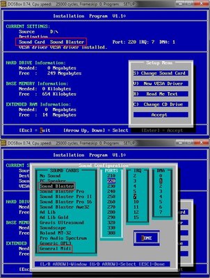

Trying to figure out something:
Game's setup program only allows setting ONE Sound Card (so no SB/MIDI combo). It's a damn shame because with SB you get nice SFX & Speech (and shitty music) while General MIDI provides pretty good music. I all but gave up trying to set up both but before that I though to give this board a shoot. Tried SB with 330 port to trick it but it's too smart for that. SETUP/SOUND.CFGs are gibberish to me but perhaps hold the key to this. Any ideas or should I just drop it?
Game is CD-ROM version, not Floppy.

Reply 3 of 5, by Osprey
I got it working. It ended up being extremely simple. Go into the DRIVERS folder, rename SBPRO2.MDI to something else, make a copy of MPU401.MDI and rename that copy to SBPRO2.MDI. Select "Sound Blaster Pro 16" in the setup program and give it the usual (ex. 220/7/1). The SB16 setting uses the MIDI driver for the SBPro II.
Reply 4 of 5, by Nilex
Am I glad to have met you 😀 It works! Simple but effective. Thank you!!
