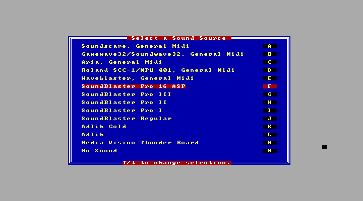

Regarding just DOSBox emulation and only sound effects and digitalized speech. MIDI is of no concern.
Emulation accuracy is important if you may. So for example if Pro 16 has more quality sounds but is not
as accurate as plain SB regarding emulation, then I'd lean towards SB despite it being less epic sounding.
I've only just realized Pro 16 is supported... up until now I've been using SB/SB16 whenever the game setup allowed it.
In my recent finding Pro 16 has VERY slightly more natural digi speech than SB. But I wouldn't bet on it, could be placebo.
What you guys say, any ideas/thoughts? Doesn't have to be in-depth, the simpler the better please 😀

There's no such thing as a SB Pro 16. There was the SB Pro 2 and then there was the SB 16. Occasionally, a game may list "SB Pro 16" as an option in its setup program, but that usually means "select this if you have a Pro or a 16." I don't know why High Seas Trader lists that option even though it has separate Pro options. It's probably an error.
SSI games believe otherwise <=|

I'm 99% sure that the "Sound Blaster Pro III" was an alternative option for the SB pro II driver if it wasn't working, you would find the same driver in the game folder with some minor difference.
Sound Blaster 16 was Pro compatible in terms of OPL3.. Software for the Pro was advertised to work. So that probably explains the sb pro 16 😲.

It just means if you had an 'sb pro' compatible card, you'd try option 1, if your compatability was shit and option 1 didnt work, youd drop to 'sb pro ii', then if that didnt work youd try 'sb pro iii'.
there were varying degree's of compatability from the clone makers.

Dark Sun - Wake of the Ravager, info from SOUND.INI:
Sound Blaster Regular
Digital Driver: sbfm.adv
Digital Driver: sbdig.adv
Sound Blaster Pro I
Midi Driver: sbp1fm.adv
Digital Driver: sbpdig.adv
Midi Driver: sbp2fm.adv
Sound Blaster 16 ASP
The options: Sound Blaster Pro II, Sound Blaster Pro III, Sound Blaster 16 ASP are the same: Sound Blaster Pro digi at 8-bit 11kHz or 22kHz + OPL3 FM Music. There is no technical difference in how the game or Miles drivers handle these three cards.
(PS: a real SB16 would not be able to do stereo in SBpro mode. DosBox SB16 emulation does not have this bug though)
