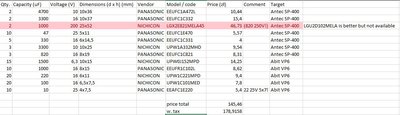

I am aware that Jamicon aren't best, but apparently I wasn't able to source better ones locally. Now I am preparing to recap other components and here is what I came up with:
89.75 KiB
332 views
I probably won't buy two capacitors marked red as they are pricey and don't even match parameters of what is needed. I will try to source them from some dead PSU.
Any comments about my picks? Almost all of those are thicker and taller than the ones used on Abit board, so I will need to place some of them on side (those between AGP and PCI ports).

Reply 9 of 11, by gdjacobs
The one you've marked in red will be the primary bulk cap. You probably won't have to replace it as it generally experiences the least amount of stress, although doing so is certainly not a problem. Also, the bulk caps will be quite tolerant, so you can use a longer life (Japanese/known good) capacitor with higher ESR than the Nichicon without issue if it saves on budget.
Do you have information on the capacitors originally or currently installed? You might be able to further fine tune the matches based on the specs of the original parts.
Reply 10 of 11, by forteller
I managed to dig Nichicon 1000/200V caps from dead laboratory equipment, so I will have that covered 😀
I have original caps right next to me. They are branded Fuhjyyu in case of Antec power supply and Jackcon on Abit board. Main problem is their size - Antec's caps are very thin in diameter and Abit ones are lower than usual.
