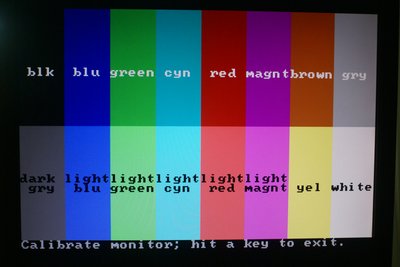

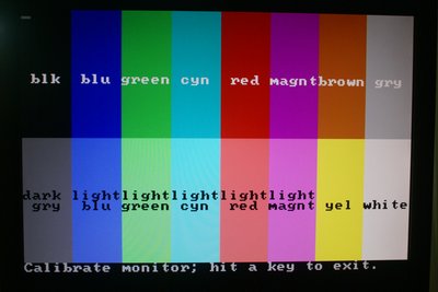

Reply 173 of 341, by ibmapc
OK that last one is very close to the 2-17 commit. The colors here from my camera don't quite match what I see on the display. But, they are very close.
960.35 KiB
1179 views
2-17 commmit
966.03 KiB
1179 views
last commit

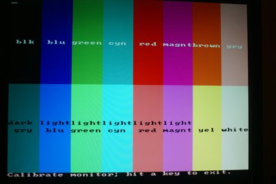

Reply 174 of 341, by ibmapc
Those last pictures were in 640x200 mode. This next one is in 640x350 As you can see, the grey is almost pink and the dark grey looks kind of green.
941.79 KiB
1179 views
Last commit 640x350 resolution (ATI EGA Wonder)
Reply 176 of 341, by ibmapc
Nope, I've been taking all pictures with the monitor set to factory defaults. If I tweek the colors, I can make some improvements. But, the grey is still slightly pink and the white text turns a little blue. I can not make it perfect in 640x350 no matter how much I adjust the Monitor. I've tried this with two other LCD monitors and get the same result. If I take the converter out of the equation, and connect my Multisync monitor directly to the EGA Wonder, the colors are spot on. So, that would seem to eliminate the video card as the problem. The colors in 640x350 resolution have been off all along. I just haven't complained loudly enough!
Reply 177 of 341, by retrocanada76
I know EGA cards needs a jumper to use the pin 2 (secondary red) otherwise it will be grounded. This could shift the colors. If I don't set this jumper I never get full white.

Reply 179 of 341, by retrocanada76
I just tested my ega card and is fine. Can you check if any of your Secondary red, green and blue are shorted ? Because these pins are not used in the 640x200 resolutions. So if they are shorted you get wrong colors.
