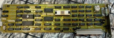

Hello all
Big thanks to retrocanada76 for his great video scandoubler. I build one today and tested it with all my video cards including MDA/Hercules and CGA clone. Image quality is perfect at all!

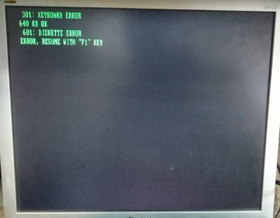

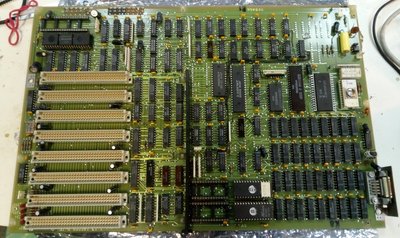

But I have very interesting old soviet computer named "Poisk". This computer has almost CGA compatible video adapter build on discrete logic without using MC6845. So, video output is TTL CGA compatible. And your mce2vga converter display image propertly. But i see Jitter on pixels:
Youtube video: https://youtu.be/2no88SHgtI8 (text mode)
https://youtu.be/l8Kz0SOA_hI (graphics mode)
Do you think this is possible to do something?
I dump HSYNC, VSYNC, I, R, G and B signals using Saleae Logic 8 and save capture. If it help, you can dowload Saleae capture file from this link: https://yadi.sk/d/gwyTHsY83TW5UL
Tronix what happens is that the Poisk pixel clock is slightly different than the CGA. Even if you could manage to change the FGPA code to match this pixel clock, then the fpga board would have same jitter for regular CGA cards.
The CGA pixel clock is 14.3181Mhz and it comes from the motherboard.
Try to identify the poisk pixel clock
wrote:Try to identify the poisk pixel clock
Thanks for replay. Yes, you are right. Poisk use 15 MHz crystal for CLK, so CPU run at 5 MHz. I think pixel clock is also 15 MHz or similar, not 14.3 MHz.

wrote:Not a requirement, but I starts to run less reliable above 115 that's why I left if around 114.
Thanks for replay. I remove all other clock for EGA and MDA. This allowed me to make proper clock for Poisk 15MHz CGA. Thus, now i have two firmwares - one for standart CGA/MDA/EGA and one for Poisk CGA. Thank you! Great project!
BTW, a week ago i have a new interesting computer named "Robotron EC 1834". He also has a non-standard (MDA?) video card . Pixel clock is 18MHz. Your MCE2VGA displays the image without modification (with Jitter). But now I know what to do! Thanks again.
