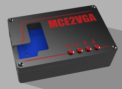

3d printed enclosure coming soon, as well... stay tuned...
or contact me if you are interested, i will have a few early on,
and more in the webshop later

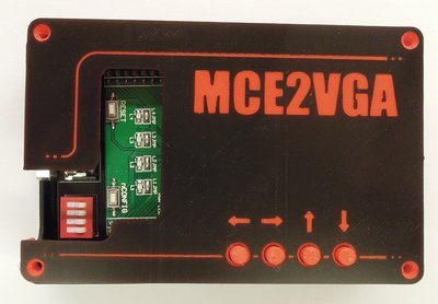

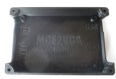

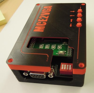

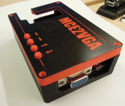

early printout, what do you think ?
still some minor changes planned : somewhat larger screw holes in lid (I didnt have/find suitable screws)

^^ Looks great as it is. The bold colouring - black and red (orange?), is very 80s. The only thing I would change is the size of the font, so that its more discrete. Otherwise, a fantastic job.

thanks, yeah the design is deliberately 'unsubtle' or 'bold', including the font 🤣
yeah on the photo it looks orange, but the actual color is bright 'alarming' red

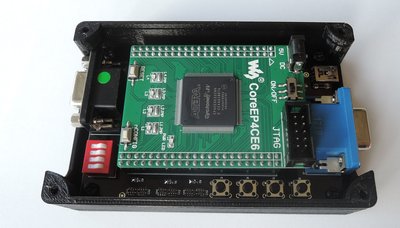

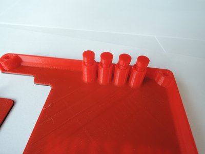

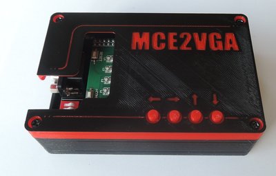

new, final 3d prints ready !
