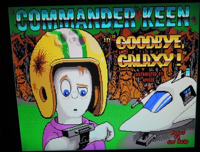

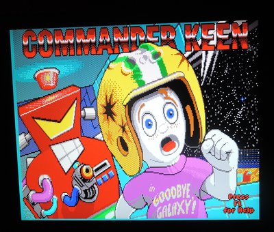

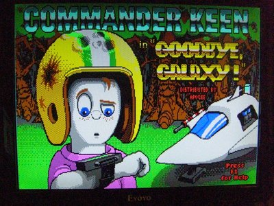

Yesterday I got a test converter from dreamblaster (2nk2h55.jpg )
I will start with the image quality that is perfect IMHO, just look at this SimCity photo:
It is my opinion though that some colors are too vibrant/hot , mainly red, pink and maybe also blue to some degree. I am not saying that the adapter is wrong - maybe that's their 101% correct values and the difference is the way CRT monitors displayed these colors, maybe they needed more brighter ones to achieve the desired effect on crt. It is also understandable that some drawing styles are meant for CRT display and the crispness of an LCD is working against it.
I took some photos - keep in mind that it's hard to photograph a crt but I am sure you'll get the idea of what I am talking about .
Gobliiins on CRT and LCD, the pink is really bright on LCD and also the tree on the left side is just awful...
Gods title screen

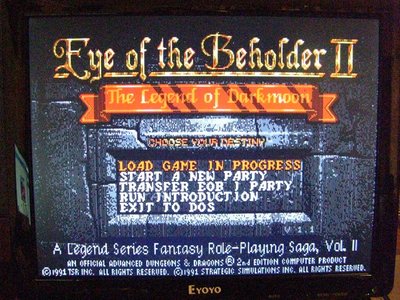

Eye of the Beholder II title screen, the banner is hard to read on LCD , it's a little better in person but still nowhere near the CRT color difference
Eye of the Beholder II in game - it's drawing style seems to produce some artifacts on LCD

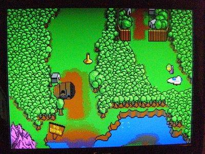

and some mandatory Commander Keen 4 photos, watch again for reds and pinks
The whole red/pink issue reminds me of what happens when I play with the COLOR MODE switch on my EIZO multisync monitor, with the wrong mode I get a similar result.
Maybe some toning-down is needed to compensate for the lcd panels? I hope someone more knowledgeable has a solution 😊

Reply 47 of 341, by Plasma
Commander Keen colors look ok on mine. How does it look if you turn your LCD brightness down?
I tried to test Gobliins but I can't find the CGA/EGA version. However, looking at this screenshot from Mobygames, it appears that your low/high intensity colors don't have enough contrast. Notice how close the reds and blues are. The dark gray is also way too light. I'm not sure what is causing this.
I tried Eye of the Beholder II and the colors look fine on mine. There is dithering which probably doesn't show on a fuzzy CRT. If you turn on scanline emulation (the last switch) it will look a little better. But there is definitely something off with yours since the light red and dark red are nearly the same.
Are all your screenshots using the same video card? I did notice that on one of my EGA cards, high intensity white appears as high intensity cyan. But on my other EGA it is correct.

Reply 49 of 341, by keropi
Plasma your lcd shots look fine... I am using an ATI EGA Wonder 800, I'll try with another card and report back
I also just noticed the lost detail on the spaceship's window on my lcd shot...
Reply 50 of 341, by keropi
well I tested with another EGA card and with another monitor - sadly I get the same results as the pics I posted above...
Plasma, what firmware are you using on your board?
Reply 51 of 341, by Plasma
I am using the Dec 16 version. As far as I am aware, the only changes since then are the OSD controls.
However, I am using the original V2 PCB design by Luis. From the pictures dreamblaster has posted, it looks like he redid the PCB to use more surface mount components. I'm guessing there is an error somewhere with the resistors, since those are used to generate the colors.
