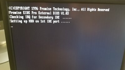

The computer started up with no errors and the Promise controller was detected. The controller model and bios version appeared on the screen. Then it said "checking IRQ for Secondary IDE...", then it said "setting up HDD on 1st IDE port..." At this point the computer just hangs. It does nothing and I have to restart. It always hangs at the same point.

Does anyone have any suggestions? I have attached a pic of the screen where the computer hangs. Thanks in advance.

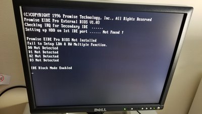

UPDATE: I removed the hard drive entirely and tried booting. Now I get past the "setting up HDD on 1st IDE Port". It now adds "..... not found!" after it, and tells me that the Promise EIDE Pro BIOS not installed. I then tried another hard drive that was completely unformatted and it also got this screen. See the updated photos. What does it mean "EIDE Pro BIOS not installed"? Any ideas? Thanks.

edit: not installed means the handling routine of the firmware is not hooked up i guess; that should be normal when there are no disks - there is nothing to handle; also this makes me think that this controller will work on a 286 - something else is amiss;

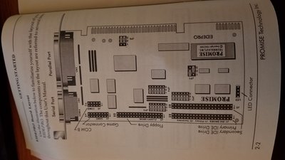

If your Promise EIDE card is like mine, it probably has jumpers for setting the address of its own BIOS. If so, try setting it to an address range other than C8000h-CBFFFh which corresponds to the IDE BIOS of the motherboard as both BIOSes may be conflicting due to clashing addresses. The "EIDE Pro BIOS not installed" message may be due to this kind of conflict.

I also tried changing the Promise controllers external bios setting from C8000H to D8000H, but there was no change.

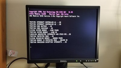

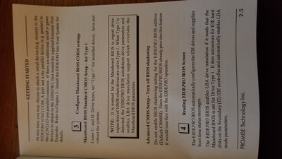

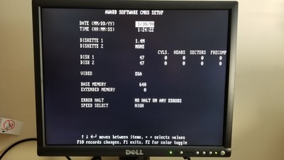

Here are photos of the motherboard bios screen and the manual for the Promise controller. For the bios screenshot, I have tried hard disk types "none", "Type 1" and "Type 47", none worked.
I also cannot find any way to enter the Promise controller's bios setup screen during bootup. There does not seem to be any hotkey to enter it during bootup.

I own one of these controllers and have attached the files that I obtained from Promise years ago. You might want to look in the EPRd100.zip archive at the eidepro.txt file for some troubleshooting tips.
Others who are offering suggestions may find the manual PDFs useful.
Good luck!

Type 47 allows you to define custom HDD geometries so you actually don't need the controller BIOS (at least not for HDDs <= 504MB). You can try the following:
1) Ensure that the HDD is clean (no partitions on it). Maybe you partitioned the HDD using a geometry different that the one the controller thinks is the correct one.
2) If the above does not work. Disable controller BIOS and configure the HDD geometry using the BIOS setup utility. Select Type 47 and put the cyls, head and sectors of our HDD or 1024/16/63 if it's >=504MB Write Precompensation is not used on IDE drives (put 65535 here).
Hope this helps.

Also, while my motherboard bios does list type 47, it does not let me enter my own CHS settings...
