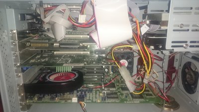

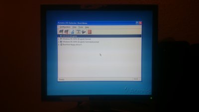

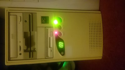

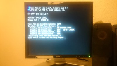

i can finally say to the world, i have completed my "Vintage" pc rig for (dos - win95 era), took a while but think it the best it could be for the time
specs are :-
Motherboard - A-Trend ATC 1000+ (Socket 7)
PSU - 200W AT
Processor - Intel Penitum 133 (With Heatsink/Fan) [Upgraded to Penitum 233 MMX]
Ram - 81mb EDO [Downgraded to 64mb EDO]
Graphic card - S3 Virge DX - 4mb
3D Accelerator - Diamond Multimedia VooDoo 1 - 4mb
Sound Card - SoundBlaster 16 CT2830 [Upgraded AWE 64 Gold (with 4mb Memory Upgrade Board) CT4390]
Network - Intel Pro/100+ PCI
Drives
- Sony CRX 160E CD Rewriter
- 3.5 Floppy (720kb - 1.44mb)
- Western Digital WD400BB-75DEA0 - 40gb HDD

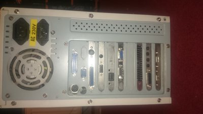

I/O Ports
- 2x USB 1 ports
- 1x PS/2 Port
- 1x DB-9 M Serial
- 1x DB-25 M Serial
- 1x DB-25 F Parallel
- 1x AT Keyboard Port
- 1x Game/MIDI Port (On SoundBlaster Card)
- 1x Ethernet Port (On Intel Network card)
Extras
- PCI Extractor Fan (Under VooDoo Card)
- 80mm Case Fan
- Saitek X6-31M Gamepad
- Keymouse 3-Button Serial Mouse OR PS/2 Mouse
Operating System
- Windows 95 OSR 2.5 (With Plus Installed)

Reply 2 of 6, by jheronimus
Congrats! Looks like a great machine
It seems like your motherboard uses an Intel 430VX chipset. So even though the maximum RAM is 128MB, the cacheable limit is 64MB. You might be getting a performance hit with your 81MB.
MR BIOS catalog
Unicore catalog
Reply 3 of 6, by probnot
80x1024=81920k...Assuming it's 80mb (64+16 or some variation..) you could just pull the 16mb portion to see if there's a difference.
