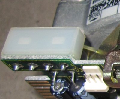

Reply 55 of 167, by SW-SSG
Too-stiff Molex 4-pin connectors... especially in conjunction with certain old HDDs...
56.81 KiB
1090 views
a Miniscribe 8425.
...yeah. Thankfully I've yet to actually break one.
