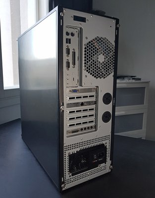

Did find an IO-shield from the hoard of retro parts that fit this motherboard, cleaned up the back of the case nicely.

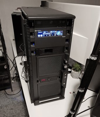

Been slow progress with the retro machine, my NAS/server project has been sucking up the funds but I did find a touch panel fan controller that fit the theme of this case.
Most fan controllers that I looked at were far too ostentatious and flashy to even be considered, Bitfenix Recon was quite understated so that's what ended up going in.
And don't worry, I'll apply a red film to the touch panel to make it match the red 7-segment display of the Gotek floppy drive. 😀
Not happy with how much the hot swap bay stands out by being a much darker tone than rest of the case, might need to find a lighter one.
