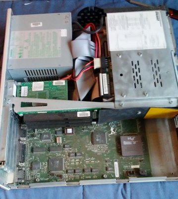

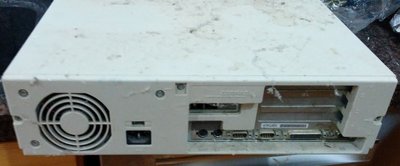

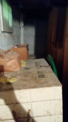

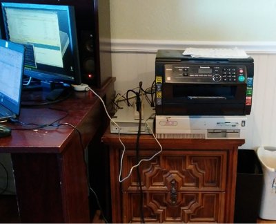

We bought a new house last year. The previous owners left an old computer (along with a bunch of garbage) in a crawlspace in the basement. I finally dug it out last week to see what it was. The computer was sitting on the old cabinet in the back.
304.81 KiB
1836 views

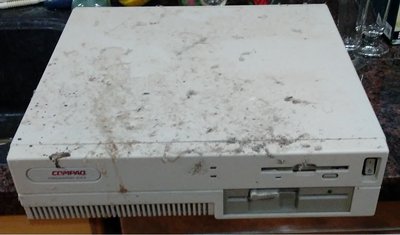

It is a Compaq Presario 633 circa 1994. It would have been a relatively low-end model for the time as it has a 486 SX and no CD-ROM or sound card.

As you can see, it is was very dusty. I cleaned it up and was able to boot it without any trouble. I snooped around a bit. It looks like this computer was used mainly for Quicken, keeping track of a bowling league, and playing card games.
I believe the hard drive is going bad and probably was even before this computer was "put away". It is extremely noisy and there logs from several scandisk runs on the root of the drive.
I went on eBay and did a little shopping. I might have gone a bit overboard. My goal is to do a few upgrades and turn this into a decent 486 DOS gaming box. Some of the things I would like to play are the old Sierra and Lucas Arts Adventure games and a few of the early FPS games (Doom, Heretic, Dark Forces).

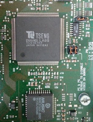

Nice find!
I can't tell the model, but that looks like an integrated TSeng VGA chip. Can you get the model number off of it?
If that's a 4000AX, that's a nice chip to have for a 486. One of the best ISA VGA chips you can get. I'm not sure how the other TSeng chips compare.
Reply 2 of 13, by Tenorman
It is a Tseng E4000/W32I. From my research, I think it is supposed to be one of the better integrated video chips from the time. That was pleasant surprise.

Reply 3 of 13, by gdjacobs
It's very (very!) fast but can have compatibility issues with more problematic games. All in all, it's a great chip.

I got the external SCSI CD-ROM working. The drive got pretty beaten up in the mail, but it works, so whatever.
I switched everything over to PS2 and am using a KVM so I can switch over to the 486 from my "regular" computer easily.
The splotch above the Compaq logo is ink. I'm sure I could scrub it off with a magic eraser or something, but it is fine for now.

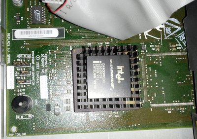

Reply 7 of 13, by Tenorman

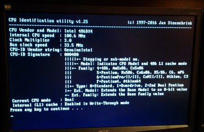

I ended up getting a DX4ODPR100 chip and installing it. I also threw in another 16 MB of RAM (28 MB total now). I won't ever need it on a system like this, but it was cheap so why not?
I did some before and after benchmarks with Phil's DOS Benchmark Pack.
Benchmark Name: SX-33 / DX4-100
3DBench 1.0c: 25.6 / 51.0
PC Player: 5.7 / 14.7
Doom (high detail, no-HUD): 14.1 / 30.9
Quake: NA / 9.7
Norton SysInfo 8.0 CPU: 71.9 / 126
Landmark: 158.2 Mhz / 520 Mhz
Topbench: 149 / 253
In most of these apps I got a 1.7-2x performance increase. PC Player and Landmark were closer to 3x. I'm wondering if PC Player is taking advantage of the FPU. Landmark looks like it is just so completely synthetic and unrealistic that I see this speed simply from the clock increase.
I think that I am pretty much done with hardware upgrades to this computer. It can play all the Doom engine games very smoothly which is most of what I was after. At this point it would be bottle-necked mainly by having no L2 cache, and there is no way to add it on this board.
