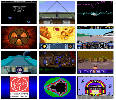

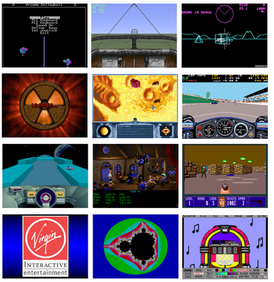

Chilly Willy wrote:
So is King's Quest V and among other games.
Yes, there are exceptions. But you claimed these are the rules:
Chilly Willy wrote:
320x200 is square pixel. ... The screen looks nice, clean, and not distorted. At 320x200, that's how the games were made.
Quite the contrary. The majority of games were supposed to be aspect ratio corrected to 4:3.
Here's a picture about a few of them: Monkey Island, Duke 3d, Wolfenstein, Dune, Indy 500, Arcade Volleyball, DogFight, Skyroads etc. And some non game examples: FractInt and Autodesk Animator:
260.24 KiB
1174 views
627.78 KiB
1174 views
You suggested that 4:3 correction must have been an anomaly by artist that did not grasp the situation right:
Chilly Willy wrote:
I won't disagree that some developers may have done that. Why, I have no idea other than they thought their game needed to fill the screen. Seems silly to me.
I do not think it was a silly idea.
Almost all the early CGA/EGA/VGA resolutions were not square pixel resolutions. But all the displays including TV sets were 4:3 displays. So games using these resolutions rightfully supposed that they would be played on a 4:3 display. Why do you think that 320x200 was an exception and it was meant to be used as 16:10 aspect ratio mode when no display in that age had a native 16:10 aspect ratio? And why do you think that other resolutions like your mentioned 160x200 should be stretched to also 16:10 an not to 4:3 as the native aspect ratio of all display devices at that time?
I have found no evidence (documentation, articles, other references) of your claims that 320x200 was a square pixel mode. If you find one please send me a link. On the other hand you can find many articles, wiki pages, etc. that explicitly say that 320x200 video mode's pixel aspect ratio was 1:1.2 just like 640x200 was 1:2.4 and should be corrected to 4:3. And what do you think about resolutions like 640x350? Are they also square pixel modes according to you? Some other links for you:
https://en.wikipedia.org/wiki/Color_Graphics_Adapter
http://www.reenigne.org/blog/what-is-the-cga- … -ratio-exactly/
http://www.vcfed.org/forum/archive/index.php/t-51820.html
https://medium.com/@felipepepe/no-ms-dos-game … io-37f86343ad65
I do not think that '320x200 is a square pixel mode because I have used my monitors for ages that way' is an argument. Yes, we do not have to agree about what we like. But I do think that facts should be accepted.
