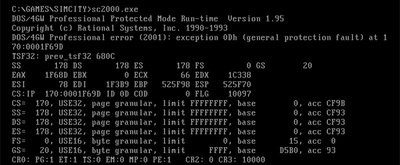

6) SimCity 2000 - after I used adpatch to a32adlib.dll game write error at startup
7) Little Big Advanture - I used same a32adlib.dll and game write same error, so possible I need different a32adlib.dll file?
Will be investigated (hold on, it may take some time to get to it)
