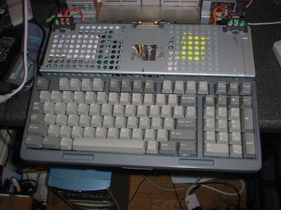

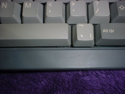

and lastly...
overhead view of the Toshiba Keyboard with dell keyswitch fitted and Toshiba Keycap replaced

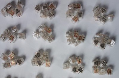

Look what I just found ...
101 x Matias Click Switches (Alps SKBM Clones) Mechanical Keyboard Switches
Not the genuine article ..but clones.
Fingers crossed they physically fit the keyboard pcb.
Got 101 NEW switches for £15 delivered..
more than enough to completely refurbish one keyboard .and spares to repair the other.

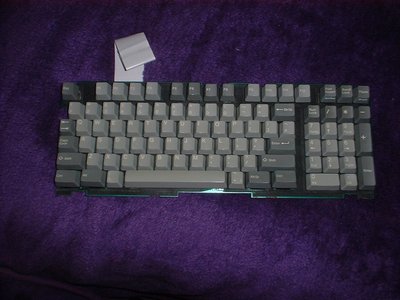

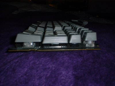

So ..the clone ALPS keyswitches arrived ..and are as I suspected ..larger than the original Toshiba key switches ..
about the same dimensions as those borrowed from the Dell keyboard ..but actually a fraction taller ..
This is not a problem for most of the keys ..but sadly make fitting where there is the additional steel retention/stabalising hinge ..a problem.
Answer ..ditch those hinges ..which just unclip ..
This makes for less stability ..and is a trade off ..
It's either that or dont have new key switches.
The only exception is the space bar ..which _needs_ stabalising ..so reformed that steel loop hinge a little.
Obviously all the keys stand a little higher now ..but generally acceptable.
..and since the new switches dont have the extra 2 'legs' ..I will have to link some of these contacts manually ..
The missing key switch legs form part of the circuitry of the keyboard acting as loop throughs.
These can easily be replaced with wire links ..but will take a while as there are quite a few needed.
Anyway ..
I'm attaching a couple of photos to show most of the main keyboard with new switches fitted ..
The other half (numeric keybad) has not yet been done ..and so a second photo showing the difference in height..
I estimate this to be between 1 and 2 mm

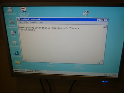

Last pix before I fully fit the Keyboard ..
It is wonderful to have a full set of working keys..
I know the key alignment isn't perfect any more ..but better functional than pretty..
