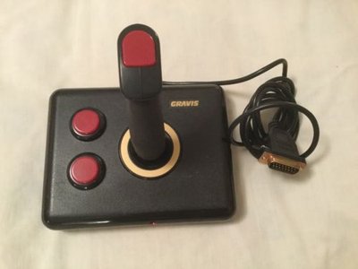

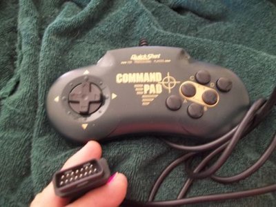

I got a Quickshot game pad and a Gravis joystick (I can't remember the model designation; the black, elegant looking ones).
The latter seems to have some spatterings of paint on it, easily fixed.
If you recall, I installed my ESS1688 sound card in the 8 bit slot and my network card in the 16 bit slot. So I was kind of concerned whether the joystick would work or not.
Commander Keen 4 worked just great with the joypad.
33.4 KiB
2048 views
Quickshot gamepad works great in Commander Keen 4

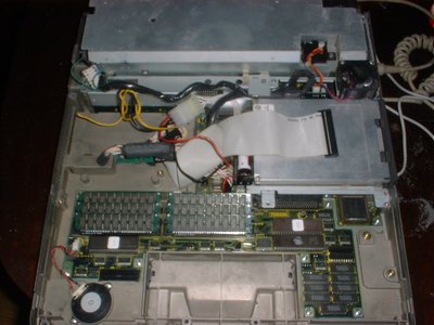

Turns out ..there is space in that useless modem compartment underside of a 3200SX ....big enough to fit the CF adapter ..
with a bit of plastic trimming.
Probably been done before I guess ..but makes for easy CF access ..
So file transfer or plug in OS ..
both are good.

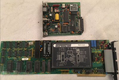

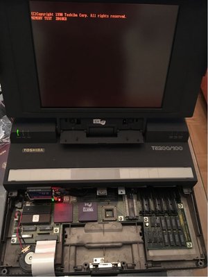

Hello, chozilla here... got myself a T5200 now.
So I am working on 3... effectively 2 Toshiba notebooks now (great job starting and never finishing a thing...)
About the T5200 I have a few questions that probably anyone can answer.
  1. Does the onboard IDE support two harddisks? I am unable to boot when I plug in two CF cards and one CF card runs fine. Could it be the Hardware only having one channel or is it a BIOS limitation.
  2. What sort of memory do I have to buy for the system?
  3. and what type of Floppy drive can I use to replace the broken internal one? (It makes noises and when I remove it the boot takes forever...)
77.01 KiB
1938 views

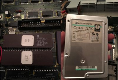

The mystery T5200/100 came with a full size IO card that I can not identify, and with a modem expansion card.
261.51 KiB
1938 views
Inside was a badly damaged harddisk and a strange bios chip that I can not read from. (images attached)
185.75 KiB
1938 views
Any ideas how to setup the system?
best reg4ards
\ chozilla

chozilla wrote:
Hello, chozilla here... got myself a T5200 now. […]
best reg4ards
\ chozilla
If that was the hard drive used in the system ..then one could only assume it already hasbeen fitted with a modded bios ?
AFAIK ..you could only ever user Conner drives with the original bios.
I would strongly suggest pulling the bios chip and reading it with a programmer such as the TL866 ..
..and letting Ian check out the 'chip dump' ..If he ever returns..?
rgds
VS
