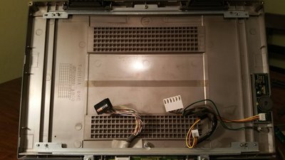

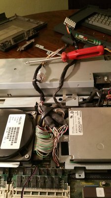

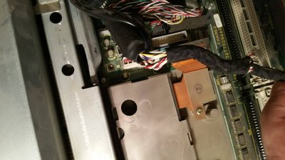

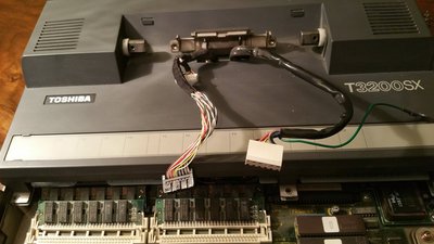

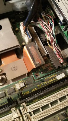

Reply 323 of 539, by OldCat
yourepicfailure wrote:
Thanks for the suggestion, however: the maintenance manual is incorrect.
Notably it labels pins 33 and 34 on machine side connector as ground, when they are actually +5v supply lines. Verified with probing and testing.
But I already have figured out the addressing scheme, I just needed pictures of other units to verify compatibility..
I have found my photos from 2017 when I was dismantling my T3200SX - won't have time to disassemble it now, but maybe these can help.

Reply 325 of 539, by yourepicfailure
Apologies for not getting the images out sooner. Had things get in the way.
Anyways, here are examples of images. Don't care the format, so long as you don't have JPEG compression that limits the clarity of a zoomed in image. ~70 quality in photoshop save for web, and 8+ in save as jpeg.
For the component side of the panel, good enough I can zoom in and make out component names. There are components mounted behind the visible board- please don't remove the board. As seen, the name of the component behind the board is silkscreened in.
For the display panel, a good enough picture I can count the pins will do.
For machine-side connector, again good enough I can count pins.
These are high res images that won't fit with the image uploader, so used an external.
https://mega.nz/#!GTJ03YjS!z_xR7v7_2ZdKsnUnT2 … Vzp-fOTmCzI0KDU
Thanks OldCat, it would appear as though your display connector on the panel-side is 16 pins. However, similar interface in terms of addressing. Looking at the maintenance manual for an idea, Toshiba termed the connections differently, but they are similar. The same three clocks to be exact. So similar logic, but made simpler (4 ttl I/O pins vs 8).
I wish I had the funds to purchase a T3200SX and T5200 to research the panels on each, but this will have to do.
