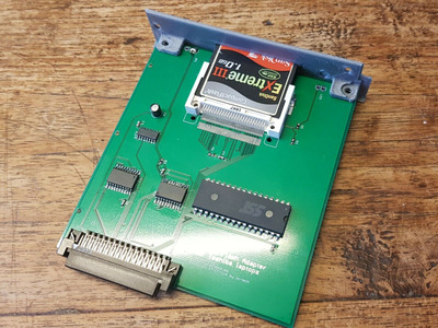

so this seems like a good time to introduce my project to this forum.
https://www.benl.ebay.be/itm/264877993192
This is an expansion card that goes into the special toshiba expansion slot.
It provides an XT-IDE BIOS in ROM as well as an CF card slot that's easily accessible from the back of the machine.
It is compatible with many Toshiba portables from the T1100+ all the way up to the T5200
One of the more interesting features that i think many people here will find useful, is that it can also easily be configured to control the internal IDE controller on machines that have one. (T3100e, T3200sx(c), T5100, T5200(c))
This allows you to have both an easily accessible CF card slot as well as the ability to change out the internal drive without running into the restrictions of the Toshiba BIOS.
I hope some of you will find this helpful

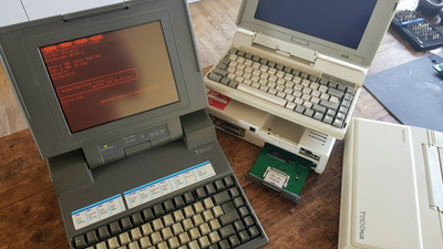

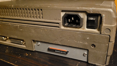

Hi, I'm sorry I should have clarified that a bit more. This is indeed the external expansion slot, Always on the back of the Toshiba portables (except the T1600 has it on the left side)
On the T5200 this is labled "EXP" above the slot. I've attached a picture of the card installed in my T5200
I think Toshiba did sometimes call it "slot A " but in most documentation it is just called "Toshiba proprietary slot"

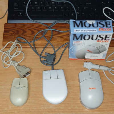

Reply 395 of 539, by shimart
adalbert wrote on 2020-12-05, 16:06:
I have T3200SXC and I found out that not every mouse works with it. What is the model you are trying to use? 3-button Logitech M […]
shimart wrote on 2020-12-05, 15:39:
However, I am having a problem with the <Serial Mouse> not working on the My T3200sx.
If someone knows how to fix it, please give me some advice.
I have T3200SXC and I found out that not every mouse works with it. What is the model you are trying to use? 3-button Logitech Mouse Man worked out of the box, but I had problems with other devices. I had to re-wire connectors in order to make them work. I modded A4Tech mouse by disconnecting pin 5 (GND) in DB9 connector and connecting it to pin 6 (DSR). I also bridged pin 4 (DTR) with pin 6.
Here are some details about getting mouse to work: Re: Connector wiring NCE-860/PC mouse (late 80s serial port)
BTW I dumped T3200SXC BIOS while ago if anyone needs it: Re: 80386 BIOS image collection
and here are schematics for replacement PSU DIY AT DC-DC power supply (replacement for Toshiba T3200SXC and others)
Three DB9 mice arrived and tested.
All three mice worked fine on my T3200SX.
I recommend the DEXXA mouse, which you can buy cheaply on eBay.
It works very well and I like it.
https://www.ebay.com/itm/Dexxa-2-Button-Combo … 872.m2749.l2649

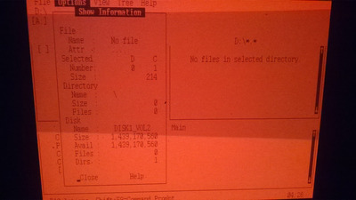

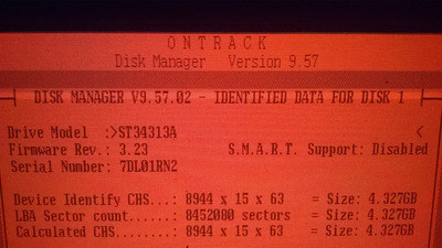

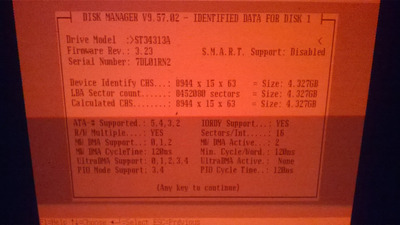

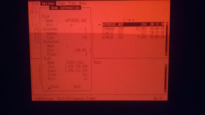

Reply 399 of 539, by ediflorianUS
LE.
Update information....
Changed HDD to a Seagate 4gb ST34313A and had no more controller errors , It formated copy-ed PC-DOS 7 ,
I can Report that Seagate 4GB - ST34313A (firmw. 3.23 /SN : 7DL01RN2) working perfectly , installed the Ontrack 9.57 and repartitioned second time to aprox 3x1.5gbs fat 16. (I think even fat32 would be ok -did not try but it is selectable)
all good , all great , no bios upgrade (just diffrent hdd) needed.
Will try installing ST25th anniversary see if it runs.
(I can report that win3.1/95 did not run/start)
