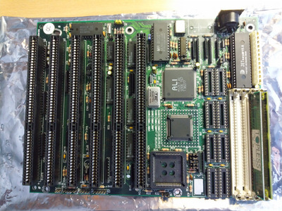

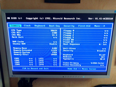

I noticed a 386SX motherboard on an auction site and asked the seller for a BIOS dump. He helped out 😀
I am not sure this one was already found before, the board has the Acer/ALi M1217 chip. BIOS ID is V1.41-ACER310.
    ACER310.zip
    40.21 KiB
    140 downloads

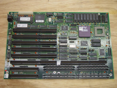

My SiS Rabbit board is a fairly old one. Looks to be 1990 vintage. It was made by a company called CTI Electronics in Connecticut. Surprisingly the company is still around, but doesn't make PCs anymore. I might try contacting them since my board is not listed on TH99, but I am skeptical they have anything I need. In any case, it uses a Revision A Rabbit chipset, and has a clunky 1990 core AMI BIOS. The layout is quite similar to the Asus board you have. It appears to only support 1MB SIMMs and up to 128kb cache, but since I don't have a manual I can't say for certain. Strangely it won't accept DLC type CPUs at all.
