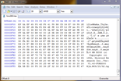

🤣 so the BIOS for the FOREX300 chipset is only 16kbytes? What is the original eprom a 27C128 ?
Reply 28 of 385, by Anonymous Coward
Wait...only 16KB? Are you certain this ROM has been dumped correctly?
Reply 29 of 385, by Auzner
No, as in I have not flashed what was read back into anything and tested. But there are readable strings in it so at least some of it looks correct. The board posts on what it had originally. Here's my photo from the thread showing a 28-pin parallel eeprom (like the model keropi mentioned): download/file.php?id=42321&mode=view
8 data pins, 14 addr pins--2^14 = 16K
You can see in the photo link that the board does not have anything on it... no IDE, no floppy, no LPT, no serial, no sound, no video. So to me 16K seems to make sense. Days of the multi I/O cards.

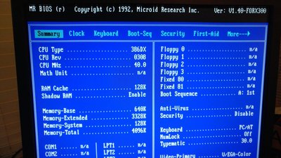

Since I got an ISA VGA card a few weeks ago I was able to confirm the board posts with my jenky AT adapter included.

Edit:
So the 27C128 is 16K x 8bits. Bytes are addressable 0000 - 3FFF

Keep in mind that the typical 386 BIOS is 64kbytes and almost none have I/O or other capabilities. The rom you dumped doesn't really match any other I've seen so far - for example the is no visible string at the beginning of it ( just download another bios out there and you'll see what I mean ) and yours has it quite down the line - which is weird. Then again we have no other FOREX bios to compare maybe it really is that weird 🤣 but that also means this one is important to have 😁
Since you got the board running why not do a dump with NSSI that jesolo mentions? I tried it and it produces the same result as my programmer. Just to be ultra-sure , not implying anything here btw as every contribution to the thread is highly appreciated and these BIOSes are hard to come by...
Reply 31 of 385, by Auzner
The only other chip I see in there is the 8042 keyboard controller. I don't have any ISA cards except for the VGA one--so no way to run software on it, otherwise I would compare the two methods. Could the BIOS be compressed? I see strings like "virus defense activated" "mr bios" and a list of the ascii chars. When I pass it to the file program in linux it reports it being "DOS executable (COM)" If someone knows how to decompile/disassemble that sort of thing it could be investigated further. I'm fiddling with it in IDA but have no idea what's going on.
