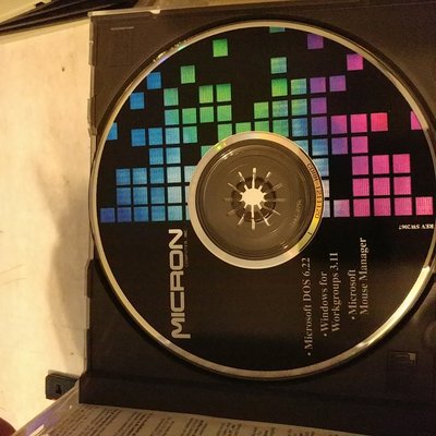

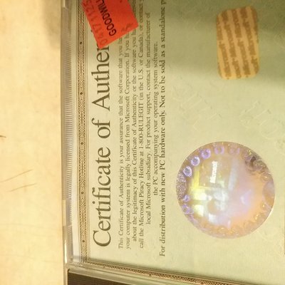

Jo22 wrote:
I seond that. If you're lucky, then there's a separate OEM CD-ROM release of DOS 6.22 and WfW 3.11 each.
For WfW 3.11, there's at least one in existemce (I own such a disc.
Is the oem release similar picked it up for a buck at goodwill. Of course its not bootable but interesting to have.
1.37 MiB
1198 views
    1.56 MiB
    1198 views
    1.84 MiB
    1198 views

greasemonkey90s wrote:
Thank you very much for sharing these pictures with us!
To be honest, I'm a little bit jealous even. Your CD is by far more prettier than mine! 😀
