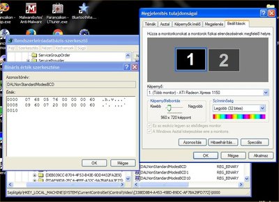

2. ATI Catalyst has custom resolution support for a very long time. Only the settings has no user interface but actually it's more easy to add/edit custom resolutions than with NVIDIA drivers that often fail to approve adding resolutions without reasonable explanation. You only have to edit 'DALNonStandardModesBCD' in
[HKEY_LOCAL_MACHINE\SYSTEM\CurrentControlSet\Control\Video\{GUID of ATI driver}\0000]
Yeah I am using XP at the moment because I am running a Turtle Beach Santa Cruz which only has XP support. I should experiment with CRU in Win7 though. That should work.
I also came across the ATI Custom Resolution Tool. That must be a homebrew GUI for the registry editing you suggested. But the problem isn't that 1600x1200 is unavailable, but that the GPU just fills 2560x1440 with it instead of aspect ratio scaling it or just sending 1600x1200 directly to the LCD. The NVIDIA custom resolutions allow you to configure both a target display resolution AND what resolution to actually send to the monitor.
https://morrisoft.wordpress.com/category/software/
I actually bought a Startech DVI EDID emulator as suggested on the forum here awhile back. But the X1800 doesn't seem to approve of its various EDID settings. Usually it just gives no signal.
Fortunately there is another option for KOTOR. You can use the old OpenGL ICD from the 7.11 driver (atioglxx.dll) and put it in the game's directory. The game will then load that driver instead. It seems to work with Catalyst 8.12, and then the aspect ratio scaling is available.
