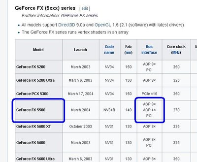

Reply 17 of 20, by PCBONEZ
shamino wrote:
I don't believe the Geforce FX5500 was ever produced as a PCI card. The "FX5500" card that Phil has shown in his videos is an u […]
BinaryDemon wrote:
I was watching one of PhilsComputerLab videos the other day about the FX5500 and they pointed out that the PCI version wouldnt work in a system without an AGP slot. I would guess its the same issue with your FX5200 since it's same generation. I don't know why this is, I'm guessing modern (starting with FX?) PCI cards all use a bridging chip to either AGP or PCIe.
I don't believe the Geforce FX5500 was ever produced as a PCI card. The "FX5500" card that Phil has shown in his videos is an unauthorized knockoff from China. That's why it has no Geforce or nVidia branding anywhere on it. If it did, nVidia would be able to sue them for trademark infringement. Assuming they can even find out who they are - there's no manufacturer branding on it either.
If it were a legitimate card, I suspect it would be *required* to carry nVidia branding. Anybody who wants to be supplied by nVidia has to play by nVidia's rules, which likely includes promoting nVidia's brand.
Somebody in China apparently acquired some NOS GPUs and built cards around them to sell on eBay. It's not only the so-called "FX5500" that this happens with.
That's not to say the cards don't work, but who knows what mistakes or shortcuts they may have made in designing them. They might have broken firmware, for example, since nVidia never wrote any for such a card.
I'm not sure that whatever issues those cards have carries over to any of the legitimate models.
55.17 KiB
2485 views
Please note that the 3.3v vs 5v and the slot keying has to do with the SIGNALING voltage [I/O], not the DC power voltage.
Those are the 33MHz, 66MHz and various AGP frequencies.
DC power is 0 Hz.
I'm pretty sure all versions of PCI and AGP have 3.3v and 5v DC power available to the card.
If they utilize or not is up to the card designer.
[Just posted because some posters seem confused about that. Others clearly not.]
