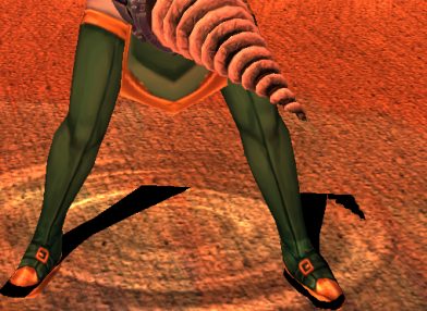

Reply 4 of 18, by leileilol
IIRC it was for the sake of buggy drivers. r_depthBits 24 and r_stencilBits 8 would be the ideal cvars and I was tired when I wrote that so it could be a misremembering. I do recall some overlapping artifacts on a certain older card with it set to 8 though.... it's been a very long time since i've tried the hacky stencil shadows
Also it should be noted that JK2MP does not allow cg_shadows 2 cue to potential cheating potential from the casting. cg_shadows 3 (a solid black shadow on the floor planes only) is still allowed however. You can force cg_shadows 2 to work by setting developer to 1.

and here's illustration of what happens when you've got too many verts and it skips. Note the lack of shadow for the body and the drillbit
