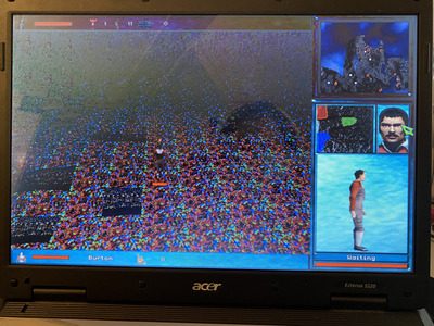

Tried out Riverworld's D3D mode (XWORLD.EXE) with dgVoodoo2 2.55, and it appears to be producing improper polygon coordinates, resulting in "stretched" polygons:
463.93 KiB
3244 views
This behavior is the same on my integrated GPU when running in software mode (WWORLD.EXE). Also, despite software mode supposedly also supporting 3DFX, it's not hooking any of dgVoodoo2's 3DFX DLLs.

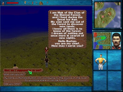

Does it happen all the time? Have you tried older dgVoodoo versions? It worked fine when I tried it (old screenshot):
988.49 KiB
3228 views
Though I didn't actually play it, just walked around for a while.
I haven't tried older dgVoodoo2 versions. Which one did you use when you created the screenshot?
Also, it happens as soon as anything 3D shows up on-screen, all the time.
Reply 4 of 17, by Expack3
Dege wrote:
How could I reproduce it? When I tried the game then didn't experience any problems. Is it a special location?
It starts immediately upon starting a new game. Also, I'm using my laptop's only GPU: an Intel HD/UHD Graphics 620.

Reply 8 of 17, by ZellSF
The MyAbandonware version should be good. However, as I've noted the graphics end up corrupt when the CD is not inserted, it's likely some sort of primitive copy protection, so what you do with the bin/cue matters. For fun I made a ISO image containing all the files on the disc and gave it the right label and what do you know, it shows movie files (it recognizes the disc), but graphics are corrupted (which means what fixes the corruption isn't something in the data files).
At any rate, if you're using virtual drive software, try something else. Daemon Tools and Virtual CloneDrive should work. Also try using a physical disc.

Reply 10 of 17, by Dfros
ZellSF wrote on 2021-08-28, 18:02:
Thank you, Daemon tools works like a charm . seems that not every Iso mount device works equally.
The polygon displacement is gone, now only the ground textures are scuffed as on the image atachment (3d models are fine). I'll try to figure that out now. at least it is playable now 😁 thanks for helping me to get the yought memories back on track an finally being able to finish this game!

We got some result: the scrambled polygons are a sort of game copy protection. The game performs a CD status check about the overall length in millisecond units and compares the returned value with the value 4788001. A good CD image and an accurate CD emulator (like Daemon Tools) makes the trick, but it is also possible to use DxWnd and the mci hack feature to force the CD length to the expected value.
The whole story here: https://sourceforge.net/p/dxwnd/discussion/ge … /b0817f74/#a864
