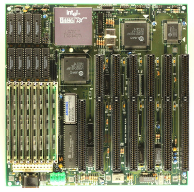

Reply 170 of 288, by BreakPoint
Another board i heed help with. Manufacturer is PCChips but i cant find model
BIOS ID is
X0-0100-001437-00101111-060692-PC CHIPS-F
    496.16 KiB
    1093 views
My CPU collection - Looking for hardware in Ukraine - Ukraine vintage PC forum
Reply 171 of 288, by Deksor
Good question we are wondering the same thing https://www.ultimateretro.net/en/motherboards/8433
Reply 172 of 288, by BitWrangler
Any sticker on the side of the end ISA slot? Sometimes that offers a clue.
Reply 173 of 288, by Am386DX-40
Doesn't actually look like a PCChips to me. Missing the version on the corner next to the keyboard controler, has an AMIBIOS sticker (pcchips usually have some generic word there), has real cache (some pcchips have that though)... still looks "too tidy".
Reply 174 of 288, by Deksor
Well this is true, but the POST string says "PC CHIPS" and it has the pcchips id string.
The "wrong ROM" is also not an option since we have a bios on ultimateretro which is the same.
Maybe they released this board under the pcchips brand but actually made a decent board for some reason. Or maybe some other shady manufacturer stole a pcchips ROM to put it on there.
Pcchips not using amibios stickers is wrong though, at least for that era (this is true for later boards) : there's one on this other 486 boardhttps://www.ultimateretro.net/en/motherboards/5944
And also the infamous m919
https://www.ultimateretro.net/en/motherboards/582
