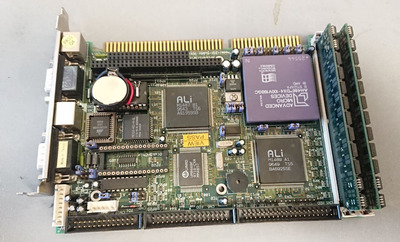

Looking for an updated BIOS for the IEI SSC-5X86H VER:C ISA single board computer. Haven't been able to find any images online, but it seems like the SSC-5X86H was in production for years after mine was made in May 97 according to the QC sticker. Maybe later specimens shipped with newer BIOS versions?
Dumped the BIOS from my board with Awdflash 7.83, command: awd783.exe backup.bin /pn/sy
The flasher will ask for a file to program despite the /pn switch, but that will time out after a few secs, and it will go on with dumping the current BIOS.
Attached a zip with the dump from my board and Awdflash 7.83 in case someone has use for it/wants to dump BIOS from their board.
BIOS POST string: 06/28/96-ALI-1487/89-2A4KDD35C-00
Edit: Removed BIOS file temporarily, will reupload once I got a verified correct backup.

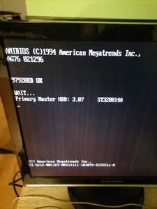

Hello, does anybody have a dump of the specific bios in the attached photo?
The motherboard is a really strange MSI-MS5124 socket 7 , but with a specific bios version (AMIBIOS AG76).
I have tried with all available bios files from the retroweb - SI3 and SI7 , rom files AG77 and AG79, with no luck.
It reads the image AMIBOOT.ROM from the floppy disk and then just an infinite sequence of 7 short beeps ... until I shut it down (I have waited for enough time, as long as 5 minutes).
Reply 236 of 288, by Roman555

bogdang wrote on 2022-12-06, 08:30:
Hello, does anybody have a dump of the specific bios in the attached photo? The motherboard is a really strange MSI-MS5124 sock […]
Maybe EEPROM is faulty so BootBlock can't recover BIOS flashing it from a floppy.
Or maybe there's a jumper on the mainboard that protects BIOS from flashing.
Sometimes a manufacturer (I don't mean MSI here) used one-time-programming (OTP) chips so it couldn't be recovered at all.

Roman555 wrote on 2022-12-06, 22:17:
Maybe EEPROM is faulty so BootBlock can't recover BIOS flashing it from a floppy. Or maybe there's a jumper on the mainboard tha […]
Agree ! Hmm, If the flash eeprom is bad you will not be able to re-flash and have it work. How did you "brick" your BIOS ? or did it just fail on it's own ?
If you have an eeprom programmer (TL866 type) you can try to flash the chip, it will also help to find if the chip is bad.
Searching back thru archive org there never was a AG76 released/posted for MSI or Premio but there is a AMI AG77d bios (diff than the AG77) with AMI flash 5.3 which should work IF your bios chip is OK.
One thing: never load Himem.sys or other things to flash an old BIOS unless you know it is ok and always use the flasher tool that was meant to use for the BIOS version. Attached AG77d
added: the Chaintech 5SEM appears to have all same chipset/chips as the MS5124, will look to see if there is an AMI bios for it to try....

Reply 239 of 288, by bogdang
Horun wrote on 2022-12-07, 02:31:
Agree ! Hmm, If the flash eeprom is bad you will not be able to re-flash and have it work. How did you "brick" your BIOS ? or di […]
I have checked, but there is no write-protect switch on the mobo (I managed to find the manual).
The bios was bricked during an eeprom update using AG79 (next time I will take into account the ID bios string too), the ami flasher was launched from a startup dos floppy without any extended memory manager.
I will try AG77d with the flasher, also from the floppy startup disk.
Thank you very much for your support!
