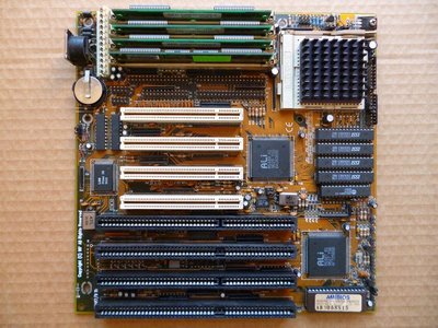

With various old PC parts, that I recently acquired, came in a stray UV EPROM chip of a 386 motherboard. I tried to identify the motherboard it belonged to, from a BIOS ID string and post image in the appropriate thread with all info, but it appears, that the 386 MB was made by a manufacturer, that no one was able to identify yet (as far as googling results shows). The BIOS ID string is 30-0201-428028-00101111-070791-OPWB, numbers in bold shows manufacturers ID, the last four letters of the ID sting probably means, that the MB used OPTi chipset which supported Write-Back cache writing policy.
The only motherboard picture I was able to source from that manufacturer looks like this:
815.61 KiB
635 views
It's marked "M1487/9 rev. B1" and nothing more.
I'm curious, could you guys pop this BIOS image in one of yours 386 MBs with OPTi chipset and confirm, that it's compatible with it? It's AMI BIOS from 1991/07/07, original UV EPROM chip type - 27C512.
386 AMI 30-0201-428028-00101111-070791-OPWB.zip
37.24 KiB
21 downloads

So the manufacturer number is 8028. On this website it refers to 3 unidentified motherboard : http://www.geocities.ws/alacidehard/BIOS.html
However one POST string brought me there Can anyone Identify/help me with jumper settings for this 486 board?
.. and then here : https://www.wimsbios.com/forum/what-motherboa … 834.html#p69808
according to TH99 the manufacturer is VEXTREC TECHNOLOGY, INC.
according to elhvb, it's Gemlight.
according to some guy on winmsbios, it's the ASK company from Hong Kong.
Hmmm not sure if it's really useful 😒

It's some stealth manufacturer. I've scrolled through the 386 BIOS collection thread and found that this 80386 BIOS image collection motherboard is the closest match for the BIOS image that I got. Compared both images and they are very similar, so it probably belongs to the OPTi 82C391/82C392/82C206 chipset.
Reply 35 of 154, by Thermalwrong
The board in that picture (which I also have) seems to be a clone of the BEK P405 motherboard: https://www.instagram.com/p/BjsYiyqgp4y/
So it's quite likely that the manufacturer that used the 8028 BIOS ID either cloned or made OEM variants of motherboards.

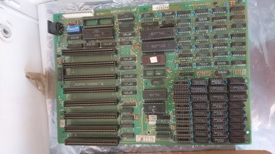

Hello
I have a Compumate Super Turbo V mainboard without a BIOS chip.
I have a blank Hitachi HN27C64G-15 EPROM that is compatible and I need a standard BIOS that works well in this board. I don't need anything special, just a stock BIOS that fits this 8K chip. (the chip in the mainboard is from another XT and it has a german BIOS).
Could you link me a compatible (english) BIOS? Thank you.

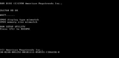

Regarding #24: Works in PCem as "AMI 386DX clone":
17.81 KiB
789 views
For #21 PCem also shows only a blinking cursor. I have to check the dumps again...

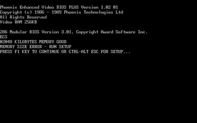

I would also very happy if you could add all the ROMs uploaded in the SUNTAC thread:
Suntac 80286 Mainboards
For the Phoenix BIOS it seems that version 3.03 does not run in PCem (but in MAME it does as shown by you). Even more surprising the older version 3.01 - which I found in another forum - works. I also tested it on a real SUNTAC board, it works there too.
