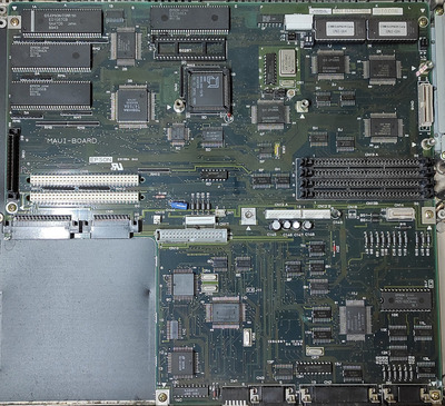

Reply 77 of 108, by jensma
#69
EPSON MAUI-BOARD Equity LT-286
2x M5M27C256AK EPROMs
Reply 78 of 108, by jensma

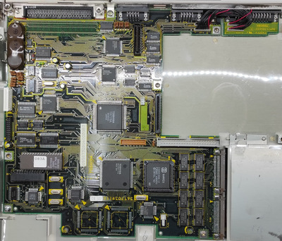

#70
36T703911G FH5SY4 Toshiba T1200xe
1x AM27C010 EPROM
    toshiba.zip
    30.1 KiB
    106 downloads
    1.27 MiB
    3211 views

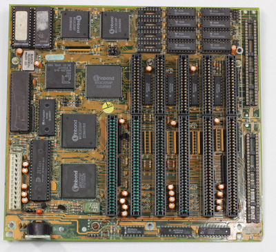

Reply 79 of 108, by BreakPoint
#: 71
Manufacturer/Identifier: KT216WB 5/HI REV 2
Chipset: Winbond W83C20x
BIOS/Version: -
None: Copied from dead board
    1.13 MiB
    3185 views
    KT216WB.zip
    46.47 KiB
    101 downloads

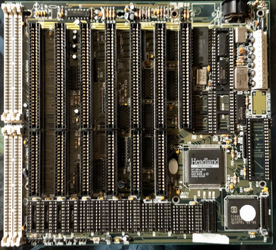

Manufacturer/Identifier: ASK CAT102
Chipset: Headland GC101A/HT102B
BIOS/Version:
1.53 MiB
2385 views
286_CAT102_Headland.zip
1.59 MiB
78 downloads
