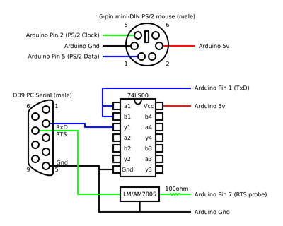

There is also code and schematics to make a PS/2 to serial adapter using an arduino board.
https://youtu.be/R_H84iGJeDo
https://github.com/Lameguy64/ps2serial
I think USB would be much more useful in the long run.

There is also code and schematics to make a PS/2 to serial adapter using an arduino board. https://youtu.be/R_H84iGJeDo https:// […]
The Schematic in this repository will not work with every computer, you should use proper max232

Reply 13 of 21, by Jo22
Thanks a lot for sharing that link! The schematic is interesting.. 😀
Is it really using a LM7805 as a level converter ? - I've never seen this before.
Weird, but interesting, still. Since the PC side is receiving data packets most of the time,
it could actually work without interruption.

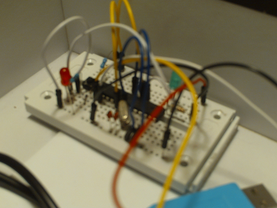

Also, it looks like a good opportunity to test my self-made Arduino:
1.33 MiB
4147 views
Edit: Seems there are also ATtiny versions of such a converter.
