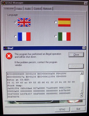

I bought an unopened Grand Theft Auto 2 disc from eBay recently and installed GTA2 on my system. After installing the game and DX6.1, I selected the British flag then tried to load the game, but am greeted by, "This program has performed an illegal operation and will be shut down." Has anyone tried this game on older hardware? I'm trying to run it on a Cyrix 5x86-133 and have tried two such systems so far, one with a Voodoo2 and one with a Voodoo3. I've tried 3dfx glide and D3D modes, but the results were the same. GTA 1 runs just fine though.
Thinking that the game may require Pentium-specific instructions, I installed it on my Cyrix Media GXm 266 MHz system w/3dfx Banshee and it ran just fine. I do not believe the MediaGX includes the instructions added with the Pentium, though maybe they were snuck into the later CPUs? The GXm does contain MMX instructions, though, so I would be surprised if GTA2 only worked with CPU's containing MMX.
Was this "llegal operation" error at game load common with GTA2 back in '99? While I don't normally experiment with 3D games past 1998, I felt the top-down 2D look might still be playable.

Heh. At least you did not get "Tragic Error" or "Mutual Exclusion Prohibits This".
Decode the assembly at CS:EIP to see what instructions these are, then check if the CPU supports them.

Reply 4 of 5, by feipoa
From memory, I recall the newer GTA2 downloads requiring DX8, which I don't want to install on such a system. DX 6.1 is as far as I want to go on a Cyrix 5x86. This is why I wanted the original GTA2 version; it requires DX 6.1. I'll try to locate the bug fixed version, and also try loading the game while the CD-ROM is spinning, or perhaps load the game from the CD-ROM's autostart menu if there is such an option.
Reply 5 of 5, by feipoa
Unfortunately, loading the game with the CD spinning didn't help. The issue may be related to gta2.exe and not gta2 manager.exe because when I run gta2.exe by itself, I get the illegal operation message.

If I try to run gta2.exe, I get the following two errors:
Error Starting Program
The C:\PROGRAM FILES\GTA2\GTA2.EXE file can't load at the desired address, and is not relocatable. Contact your vendor to get a version that is compatible with this version of Windows.
and under that dialogue box is this error:
Windows cannot run this program because it is in an invalid format.
Anyone know how to get the original GTA2 - DirectX 6.1 - game working?
