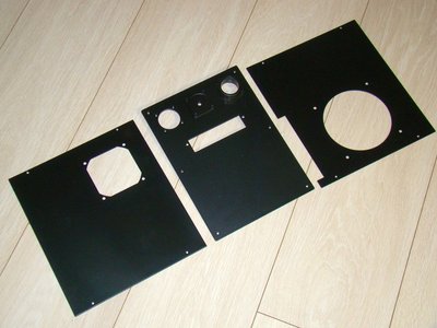

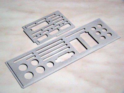

For new case I was use some parts (skeleton and back panel) from industrial enclosure.
All other panels were cutted from 2 / 3mm aluminum.
New dimentions - 265x235x195 mm.

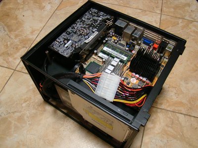

In the second section of the case will be installed ATX-system.
This is not the final version, most likely, there will be a mini-ITX motherboard.
Some upgrades :
motherboard - 60-CBXICT1.00-00
sound - AWE64 Value
AT power supply replaced by ATX-PSU

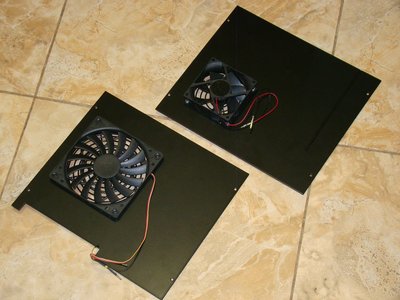

Side panels.
186.4 KiB
412 views
Front panel.
148.86 KiB
413 views

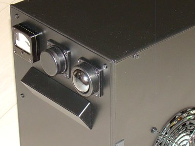

On the left -CPU load indicator (analog voltmeter).
In the center - the volume control knob.
On the right - universal indicator on the decatron. It can show CPU/GPU/RAM load, volume level, HDD activity and other parameters (some effects with him).

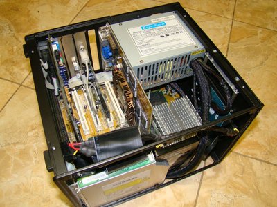

Drives in AT-section :
Compact Flash 8GB (DOS/Win98) with CF-IDE adapter
DVD-RW notebook's drive with JAE adapter
drives in ATX-section :
SSD 64GB (WinXP/7)
2,5" HDD 250GB (soft/games)
