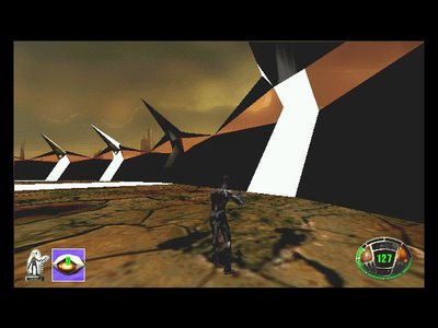

I don't know why they use Glide for this game. I always use DX7 here and it is better, didn't have many problems with DX7, let alone running on 4 GB VRAM (solved then by DxWnd). But I also didn't have projected headlights issue with DxWnd or native.
There was similar issue with MDK D3D,
58.05 KiB
5985 views
but it was solved by running software/3dfx version or, eventually, with dgVoodoo (initially only original low resolution, although I waited for long for dgVoodoo supporting forcing resolutions in DirectX mode just for this game - using Glide clearly missed 512x512 texture option in the menu).
So I think DG could fix this at some point (for DX7 mode) I guess.

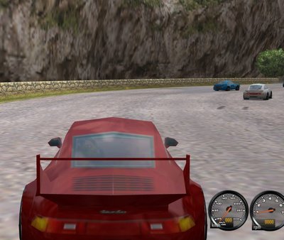

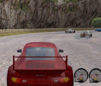

Didn't know about this quirk. If I try this for myself, what should I look for to make sure I'm experiencing this bug because the only low quality bug I'm aware of is fixed by the NFS5 Essentials patch.
Even patched, it still needs some compatibility to be set (in Win7 x64 I use); difference as requested:
LOW
120.76 KiB
5985 views
vs. HIGH
136.7 KiB
5985 views
