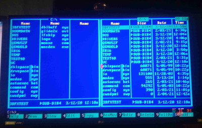

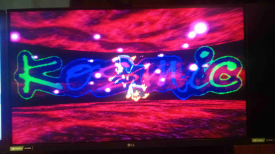

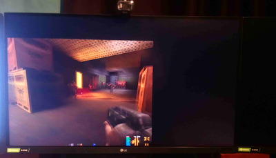

Ok, i tested all Dos 3dfx games, which i could to easy others i dont have or their setup is annoying (Lands Of Lore 2), or i dont want to play them.
It would make sense test other not 3dfx games, because so far no good? Is there any idea why games like Doom or Golden Axe are too slow?
Regardless of compatibility, which is should be main goal, i expected better performance, dont really know if these games are so badly designed that even with overpowered CPU+GPU still have lots performance drops (30-60 FPS), or its problem of Qemu 3dfx.. it would need somehow measure performance of PCem or real machines frame analysis to compare, good is that everything what is working is playable.
- RedGuard demo - I read that , at least for someone in the past it worked.

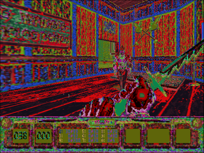

- Shadow Warrior has only broken palete which a guess would be hard to fix.
- Blood3Dfx also worked in the past for someone.
- Tomb Raider - im not sure if there is demo without static link?

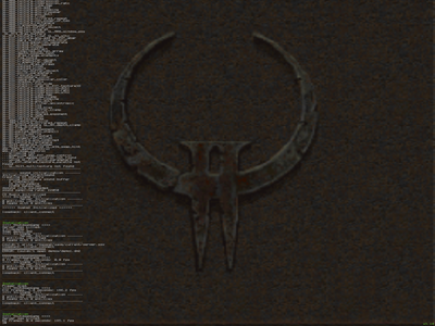

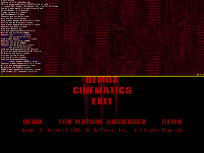

- Q1DOS and Q2DOS and H2DOS all using own Dos glide impelemtation which is not compatibile with this build, that is the shame, because if performance is there, they can give as high res with V4/F5 emulation..
With these performance results not 60 FPS lock.. PCem is cleary better solution, if you have powerfull CPU - 2D games / programs are working fine, 3dfx in 640x480 are working fast enough and all 3dfx games are working (static links) also setup is easier. Its still good to have alternative and ARM port.
Main advance of Qemu 3Dfx would be i hope in Windows 98 and high res.. but it could work (make sense) only if its overall setup would be less PITA than make these games working on new OSes with dgVoodoo and nGLide and other fan patches, so of them are great. Of course on Linux you have not other choice than this or Wine.

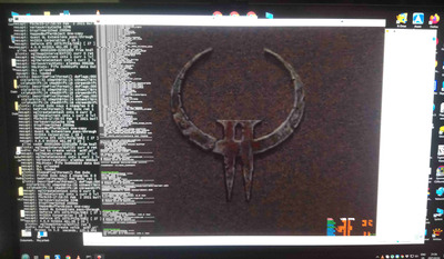

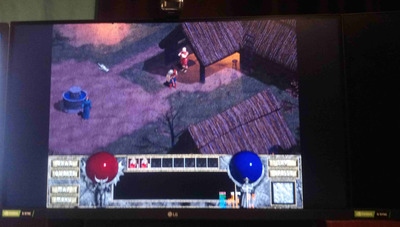

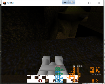

I finally got some speed with Win98, even without any HW acceleration.
1.38 MiB
643 views
740.54 KiB
643 views
There is something strange with frame counting, MSI after burner overlay is showing much less that internal game counters, ~ 1/2 half. Its maybe is how Qemu internal / erxternal displaying is working.
I have to enable Quake 3, internal overlay, because i measured 50 FPS, but from my feeling it was quite choppy like 20-30 fps, but i could be wrong, it needs more testing.

In Dos is always wrong in Fullscreen:
428.4 KiB
600 views
324.82 KiB
600 views
In Win9x Desktop is right + and 2d games are righ (4:3 forced) fullscreen on whole monitor:
387.5 KiB
600 views
Win9x Qemu 3d in Window mode is right:
652.08 KiB
600 views
Win9x Qemu 3d mode in Fullscreen - is wrong, picture is place in left- bottom as resolution is not change is drawning 1600x1200 etc picture on whole 2540x1440 canvas (monitor resolution).
252.73 KiB
600 views
BTW in theory some speed, framerate problems could be related to my refresh rate 144, even some modern, games, apps have problem with tha, are hardcoded to 60. That for old games it should be right as back in day fast refresh rate CRT monitors.

Update: i made Q1Dos running (OpenGL-Mesa and glide3.dxe from RobertMo package, No Hax(with it crash right after execution)), but it took couple of minutes to load and slideshow, missing textures and maybe is Dos settings sound related (but probably not -nosound is the same) , i dunno.. and some texture are missing:
258.12 KiB
561 views
GPL-2.0-or-later
In console is only this:
glidept: DLL loaded - glide3x.dll
trace: _grGlideInit@0 called
glidept: f6c9c59-09:12:50 Feb 3 2021 build WRAPFX32
glidept:
Extension: CHROMARANGE TEXCHROMA TEXMIRROR TEXUMA PALETTE6666 FOGCOORD TEXTUREBUFFER GETGAMMA RESOLUTION
Hardware: Voodoo4
Version: 3.10
wr2x_trace: _grGet@12
wr2x_trace: _grSstSelect@4
glidept: grSstWinOpen called, fmt 1 org 1 buf 2 aux 1 gLfb 0xfac00000
glidept: LFB mode is Shared Memory (fast), One-copy
window 640x480
30 frames in 5.1 seconds, 5.9 FPS
Update 2: Ok performance and slow loading problem was really caused by inactive EMM386, never saw this on real machine.. Texture problems are still here. With hax it is still crashing right after start.
Its not solutions of all problems, Doom2 are still slideshow, it need that hax removal but, after that is for change too fast..
As i wrote its minefield run like experience (mines=bugs), you can find "right" way how to play games, but its complicated.

Here is Shadow Warriror broken palete picture:
