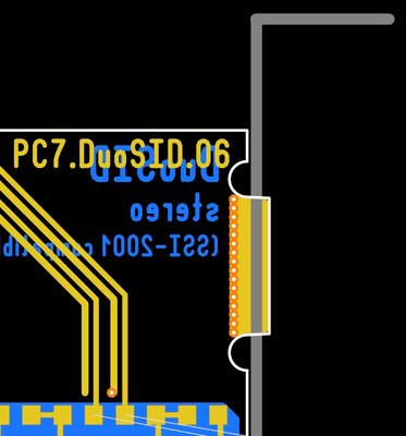

An alternative might be to use threaded jacks and pots, so you can hold the bracket on with those, and no need for 'ears' to screw it onto the PCB.
Reply 141 of 555, by SirNickity
Friendly suggestion: Think about the stresses applied to a card when fastened to the case. I dunno about you guys, but I have a couple of cases where the motherboard / slot fit is uh.. somewhat less than precise. It's probably worth trying to accommodate some compliance into the mechanical mount. Those PITA bracket ears are rigid, but do still offer SOME leeway for the bracket to fit independent of the card. I would really hesitate to use anything soldered to the PCB, as they will bear the brunt of the opposing force if the bracket is not aligned well with the slot. The nylon mounts look OK, but probably won't "give" much.
Now, I've distributed a whopping zero products to the market, so grain of salt and all that. Just some food for thought. If it were my project, I would probably pony up for a well-made bracket with good through-PCB screw mounts, even if it costs more than the PCB to manufacture -- but that's me. I know these things add up quickly.

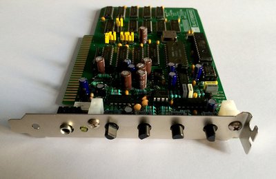

Reply 148 of 555, by keropi
Those "ears" are the most expensive feature to add to a bracket - IMHO unless someone can produce them at a friend's machinery the cost is prohibitive.
The ARGUS approach is also good IMHO -> make the pcb arrangement compatible with the vibra16 cheap cards so you can buy a random eBay card and steal the bracket.

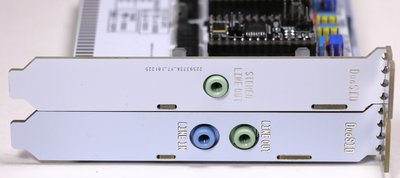

LABS wrote:
The hardest part was (of cause) making the metal brackets. It took about a month to find a proper solution, because the factory I was hoping for at first, made a sample which was unacceptable. They cut the form somehow ok, but were unable to bend it well. The drilling is in progress right now and the brackets will be ready in 2 days 😀
I probably can make an example brackets for you from FR4 if you'll give me hole positions/sizes. It probably will require some modifications for card, but probably it can be done for the next batch (if there will be any?).
Like this:
361.43 KiB
1358 views
DuoSID brackets
It holds up pretty well, can provide some flex, conducts to the case like metal one and can be made any in color (from PCB color palette). And it is not expensive.

Reply 154 of 555, by LABS
Finally the brackets are ready and I'm very pleased with the result.

Awesome work! Considering how much time it took to drill and fit a bracket to the SnarkBarker, this is surely gonna be a heaven to put together! 😀
Just a side note, without any real intent to change anything anymore: I just recently found that e.g. Mouser does offer Keystone Brackets with ears, like e.g. the 9202 - it might not fit this version of the PCB, but maybe it could be adapted to fit a future version (if planned). Means it would then maybe just need the remaining drill holes and no fasteners.
Indeed! The guy who drilled them made an awesome work. And these holders are dead-strong. I was sceptical at first and thought they will give the plastic feel, but they actually do not. The bracket sits firmly to the board, just like with 😳 "THE EARS" 😳

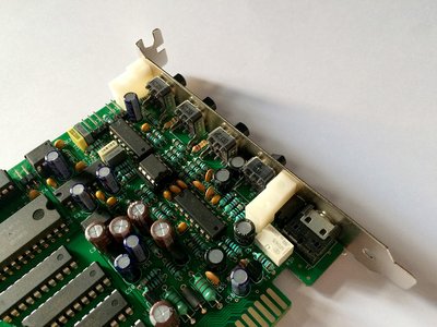

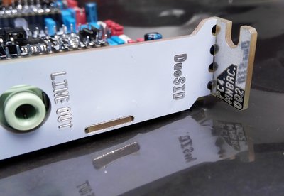

Reply 159 of 555, by Fagear
LABS wrote:
Fagear, how do the parts hold together? Glue? I like that the outputs are signed, I really miss it in bb.
Parts are held by fiberglass ledges and solder.
530.17 KiB
1272 views
Parts are held together by fiberglass and solder
Assembled bracket is attached to the main board either by nuts on connectors (like with metal brackets) or by the same fiberglass ledges and solder.

Mounting points
That's why I told you about some modifications to your "main board". Since there are no connectors with nuts, you have to reserve a little space for large solder pad and add a ledges to the outline of the board.
88.28 KiB
1272 views
Fiberglass ledge and solder pad
The most physical stress goes into fiberglass ledges, those prevent bracket from sliding away from the board when inserted and pulled out. The same goes for inter-parts connection - fiberglass ledges keep top small piece from been torn away while applying tension to the bracket when installed.
You can screw in the whole assembly into PC case and it will hold the board in slot even without solder at all. But it will fall apart without solder when not inserted.
