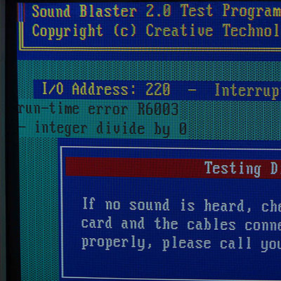

Well... it did some time ago, but now:
104.26 KiB
1506 views
I've made quite a lot modifications to firmware since then. Obviously goes to my checklist.
I have test-sbc.exe v1.91. Which machine did you use when ran it with a real OPL2? I still have OPL2 detection issue on P166 - it is successful only sometimes, but on 386 it is ok on every run.
"a trial DMA transfer for recording" - as I remember it tries 0x24 or 0x2C command for IRQ/DMA detection.

That runtime error looks like the typical Turbo Pascal problem when running on a too fast PC...

Reply 53 of 555, by LABS
newold86 wrote:
At what moment is it happening ?
Just after "Test Menu" -> "Sound Output"
newold86 wrote:
PC XT
Actually, it's strange - I assume there is only discrete logic in the circuit (no MCU involved) ?
No MCU. When you run something like Ultima 6 or Prince of Persia on a too fast PC - the music is a mess, nevertheless some notes do reach OPL2, so the same is here.
Update: After disabling QEMM there is no run-time error anymore, but no sound as well, it just hangs.

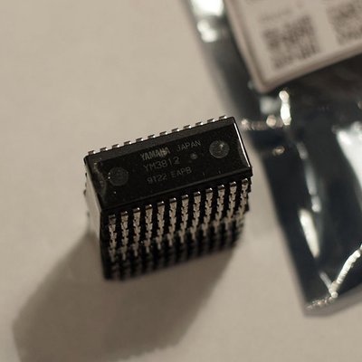

Reply 59 of 555, by LABS
Just received some fresh OPL2s 😀
