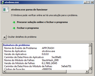

Reply 83 of 100, by filipetolhuizen
Right now, only Battle Chess runs without sound due to the VM being run in Enhanced mode (this message is shown on start and when trying to enable sounds) and Darkseed II crashes upon start, just like in wowexec on 32-bits Windows.

Reply 85 of 100, by filipetolhuizen
crazyc wrote on 2020-05-18, 02:46:
This requires highly accurate 8254 emulation, this probably won't be fixed anytime soon if at all. […]
filipetolhuizen wrote on 2020-05-18, 02:06:
For me it crashes if run from the cd but a minimum install and run from the hdd it works. I put a PR, https://github.com/otya128/winevdm/pull/684, to fix the opening credits movie. The other movies require indeo 5 to be enabled, https://github.com/juanitogan/rbxit/wiki/Inde … o-codec-install
If I run from the CD, it just plays a MIDI with a hand cursor and a black screen (I can also hear a critical warning sound from Windows itself). Minimum install still crashes for me even after enabling Indeo 5.0

Reply 92 of 100, by crazyc
I think the cd files need to be in the root directory. Use subst, a full install or something.

The long path is overwriting the stack.
Reply 93 of 100, by filipetolhuizen
Makes total sense conidering it's a 16-bit game. I'll try that.

Reply 95 of 100, by filipetolhuizen
crazyc wrote on 2020-05-23, 22:00:
This is the same crash as if it's run from the cdrom. Turns out it's intentionally dereferencing a null pointer. Try https://ci.appveyor.com/project/otya128/winev … 705sc/artifacts .
Thanks! It's working 100% now. Mike Dawson's animation is a bit jerky, but I guess this is a side effect of the game running on a faster system than it was meant to be played, not from winevdm.
