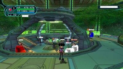

Hi there is an issue.
I installed this for PSOBB to see if it worked better or the same as the directx8 to directx9 wrappers from reshade.
There is no issue with the reshade wrapper that I know of besides slow frame rate at very high res in a few spots which might be hardware limit.
PSOBB works great with the reshade one enabling me to play at 4K res, 2xEQ AA, 16xAF etc.
The main problem these wrappers fix for PSOBB as a directx8 game is the fact nVidia Optimus and switchable graphics on AMD no longer support directx8 so the games cannot be detected properly and ran on discrete graphics cards. None switchable graphics systems have no real issue just running directly. There may be performance boosts or other fixes by using a wrapper tho, have not tested.
The issue with dgVoodoo 2 is when starting PSOBB in classic fullscreen mode at 1080p the screen is black with just the mouse cursor. Sometimes the game launching flips out and somehow ends up in a tiny window which the game renders in fine but is too small- odd.
One thing I should mention if it has anything to do with this is I do run dgVoodoo 2 PSOBB from steam as I have a steam controller. The steam controller does not work with any game unless launched from steam or otherwise with steam open. It does add a graphical feature to PSOBB such as a virtual keyboard etc.
Anyway wonder what the issue is. Any idea?

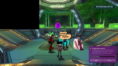

Was able to do more testing.
Window mode works.
But for classic fullscreen mode, it might only work in the monitors native resolution.
So my monitor is 4K. 4K res starts but text is corrupt. This is one of the other settings I changed is setting the game to 4K instead of 1080p.
If I set res to 1080p or anything else, something will cause the app to freeze at the start.
There could be an issue with the windows popup that asks if you want to fix your resolution or blurry apps.
The other thing to know about this game is it locks up if the game ever loses full screen focus. So if the dgVoodoo 2 wrapper or windows 10 is somehow sending a signal it should not that fullscreen has been interrupted, it will freeze.
I am wondering if the windows 10 popup that asks if your app is blurry when in fullscreen without native resolution is having an effect on dgVoodoo 2 and the PSOBB activating the games built in freeze function?
Dont know why PSO and PSOBB freeze but in the first version of the game there was no window mode. Only fullscreen and if you tried to leave fullscreen or accidentally hit the windows key or anything, you would end up freezing or crashing the game.
The way this looks I think - if I am onto the right thing - is PSOBB with the dgVoodoo 2 wrapper simple displays a black screen at start up, sometimes with a mouse cursor, or sometimes displays the first loading frame before freezing. This difference between black screen or first frame might correspond to the windows 10 popup appearing about not being in native resolution- which takes different time each load depending on factors.
Also I can confirm in regular PSOBB, if you even so much as click cancel on that windows 10 popup the game will freeze immediately. This is difference between dgVoodoo 2 PSOBB and regular PSOBB: regular PSOBB allows the popup from windows 10 without freezing but will freeze if you click the popup. dgVoodoo 2 PSOBB freezes just if the popup appears or tries to.
Also I can confirm that with dgVoodoo 2 upon starting psobb with any resolution, the game randomly starts in a window mode instead of fullscreen, but the window is so small you can barely see the game, rather than starting up in classic fullscreen as intended.
And the text all throughout the game is replaced with white or gold boxes even if you do get it started.

Reply 10 of 33, by todd
The option for DPI scaling is already set correctly.
This game handles it's own DPI so it is set to application.
I happen to be in the Windows 10 insider club, I am on a mega advanced build.
This popup box only appears if running the game in non native resolution. There is probably also a box for DPI settings too.
The box is definitely the problem. Switching to native resolution eliminates the box, and the game runs.
Switching to non native resolution activates the box causing dgVoodoo 2 PSOBB to freeze.
If you cannot get the little popup to appear on your system you may have already disabled it or are not running in sub native resolution.

Reply 12 of 33, by todd
Have no idea if the popup is causing it but that popup is a nasty biatch possibly. dgVoodoo 2 just doesn't work on my config at any resolution.
I reinstalled dgVoodoo 2 and for 4K resolution, and qHD, the game creates a mini black box in the corner then crashes.
Anyway I have confirmed dgVoodoo 2 is just a big piece of turd.
Both ENB and ReShade's DirectX8 to DirectX9 wrappers work fine confirming the issue is dgVoodoo 2 not a third party wrapper.

Reply 18 of 33, by ZellSF
todd wrote:
here's some screen shots of the windows 10 popup
That was the popup I was talking about earlier. It's about the DPI setting, not the resolution setting, which again might correlate with a resolution change, but that's not what the popup is telling you about. It's also possible in the notification to tell it to not appear again, so why don't you try that if you believe that's the problem? I don't think it is, I think this is the problem:
WARNING: Direct3DCreate8: Attempt to access Direct3D8 from DllMain. Application may need to be modified or patched to use with dgVoodoo.
Fairly sure Dege's position is that he doesn't support games that use DllMain. Maybe post about it here:
DllMain Thread
It's weird that it occasionally works though.
